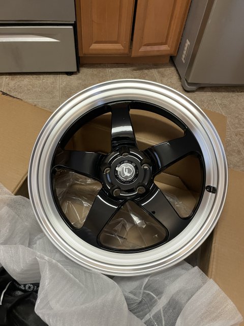

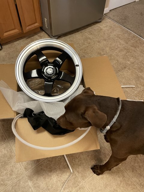

Is anyone running these on their front wheels? https://www.mandhtires.com/M-H-Drag-Tires/M-H-Front-Runner/185-50R18-FRONT I just stold my 18" RaceStars locally with Sportsman S/R. The S/R is a heavy ass tire and I'm looking to replace them with something lighter. I saw these on the site in research and was wondering if anyone has an honest opinion of them? For reference they are going on my new ForgeStar D5 18x5 wheels. Pics of said wheels...
