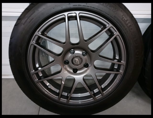

I bought these wheels used without lug nuts.
can someone send me a link to the correct lug nuts?
I’ve looked and I’m just not 100% sure and dont want to make a mistake I’ll regret at 130 mph
Car is a 19 Redeye WB

It's hard to tell in the pic if they have the conical type seat or if they need the lugnuts with flat washers. Look up the brand of wheel and that should tell you which type they take when you select the vehicle. Most good wheel fitment selectors will do that.

Those look like forgestar f14 wheels. Any conical shaped lug nut will work that uses a slim socket. I race with open lugs:
https://www.amazon.com/gp/product/B00B2FCCIU
If you feel like you need an enclosed lug nut:
https://www.amazon.com/White-Knight-Wheel-Accessories-3809L-20AM/dp/B00B2FCF1O/
lugs are lugs, all components made in taiwan...
If you are really unsure, take the information, Forgestar F14 and got to a local aftermarket wheel retailer, they can order from Forgestar their kit.

Yes f14 w/conical nuts. Those are some sexy wheels. I just ordered a pair in satin black and got those same tires too from a forum member for great price (y)
