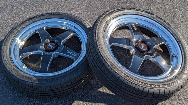

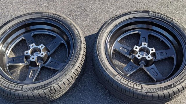

They make skinnies for your years. I have a pair on deck if you are interested with tires.

I thought they didn't make skinnies for the '21 up cars with the bigger brakes?
3,957
9,774
Atleast im not crazy, cuz thats my understanding too

They gonna be waaaay out my budget. Lol. I got a steal on my welds for the rear at $600
