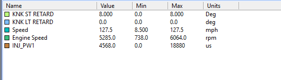

it’s spring here finally! Over winter I put in Demon Injectors, 2.85 Grip Tech, Green Filter and a 180 degree stat. Pretty basic setup on 93.
Well I did my first WOT pull today and got 8 deg of short term knock!
Injector duty cycle looked like it was 79 percent. Which is good. I was wondering how I was going to turn out running those.
The fuel I’m using is from fall but I put stable in so I was hoping it was fine. I guess I’m going to drain fuel tomorrow and hope that’s it.
Stay tuned. Hope it’s worked out by the first Saturday in April when the track opens.
Edit:

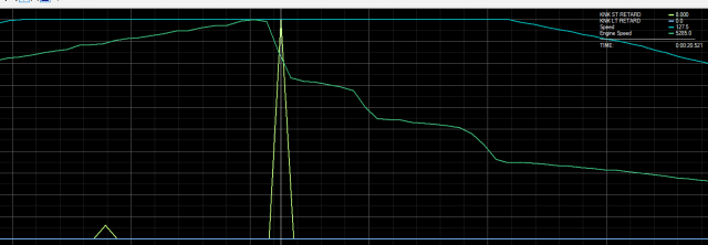

I looked at the log again this morning. The chart is confusing because speed is messed up the blue line. I don't think speed picked up again until I dropped below 127mph. But looking at rpm (Green) it looks like the knock (yellow) happened right after I let off. There is a small amount of knock it looks like in 4th but it's only .5.
Edit:
