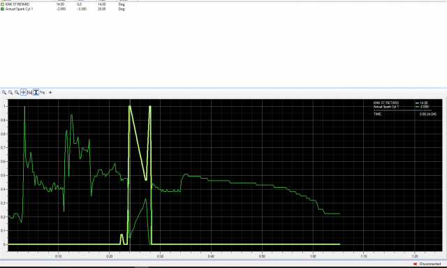

This is a drag strip pass in my car bone stock on Shell 93. STKR was logged throughout the entire run with a max of 5.5 deg which is A LOT. In a custom tune I don't wanna see more than .5 to 1 deg in a blip or two.
Sorry these are in Diablo, this was before I saw the light and switched to HPTuners.
I dropped in a couple gallons of 109 unleaded race fuel for the next pass just to see. STKR was reduced dramatically indicating the knock on 93 was REAL. I actually needed more 109 than I had added since it was still getting a couple degrees of STKR here and there but the 109 definitely helped a TON.

Here was my second revision of a tune. It was March. Poor fuel. Any time we have good DA it is usually followed with poor fuel so if I was wanting to push for the best times no way I could do it without adding some octane booster
This tuner didn't update all the tables he should have because the car actually went into negative timing. I'm sure that was great on the engine during a hard wot pull.........

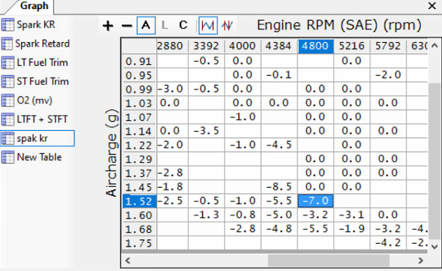

Here is a log from a well known tuner a bunch of people seem to love for some reason. I asked for a flex tune where the 93 is as safe as possible because I wasn't using it to race
Well here is some knock in a chart nicely laid out
Some of this has to do with tuners pushing cars to hard. Some of it has to do with crappy 93 in spring and fall months. Regardless I'm sure these tunes were close to 0 knock on great 93 and summer months.

@jonx96 so in your first screen shot it would show a commanded 12deg of timing. Is that on a stock setup or with a pulley and what RPM? Something is definitely funky with that. Calibrations have a "floor" (how it was explained to me) that is the lowest possible timing value after all modifiers. -2 was probably where yours was, so it basically just yanked all of it for some reason. A spike that slowly drops (decay rate) is usually something funky going on. Could have been some knock and the car over reacted for some reason.
The table you posted is more interesting. Same question if it's stock car or pulley installed? The rest of the story would be commanded timing in the tune. On my car, there were a few RPM areas after the pulley (maybe before too) where it was prone to resonance and noise from the supercharger that set the knock sensors off. On mine 4,000 RPM was a real noisy spot.
Once you get in to custom tunes and pulleys on 93 things get even more interesting beyond bone stock racing on 93 which is what I was trying to highlight in my post.
Both logs were with a 2.85 pulley. I have no idea what the first log was for timing because it was diablo.
The second tune maxed at 14 deg. Which in my books is not a conservative 93 tune and a max effort tune for a 2.85 and 93.

Also octane booster fixed the knock issue of the first log so I know it was real the second I never tested. But I never run 93 so wasn’t even worth the test.
