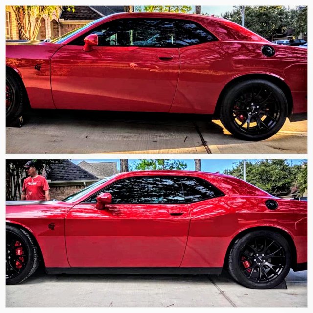

Alright they are in! I didn't see much difference in the front at all! The back did come down, but I also did the heater hose trick. I didn't have any power tools, and it took me all damn. I am getting to old for this crap...lol. I felt it the next day. Waiting on my 305/35r20 Firehawk Indy 500's. Have the replica 10.5x20 wheels in the garage. IMG-20190921-WA0002~2.jpg

Mopar springs don't lower the front much more the rear. It looks great!

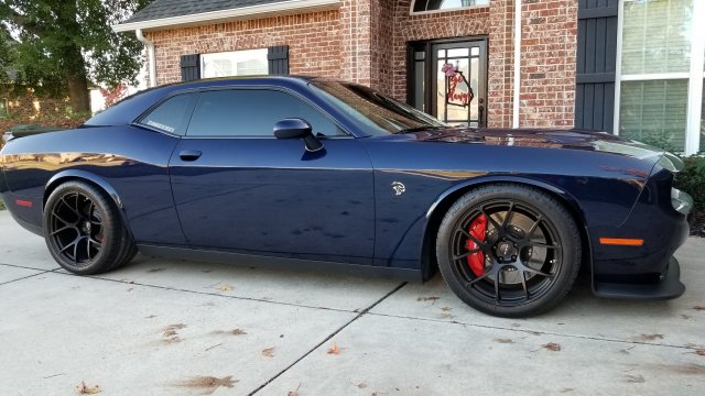

This was my car with Mopar lowering springs, the rears had a half coil cut off.

Looks good, def not much drop on the mopars compared to eibach, but the look is spot on!!
