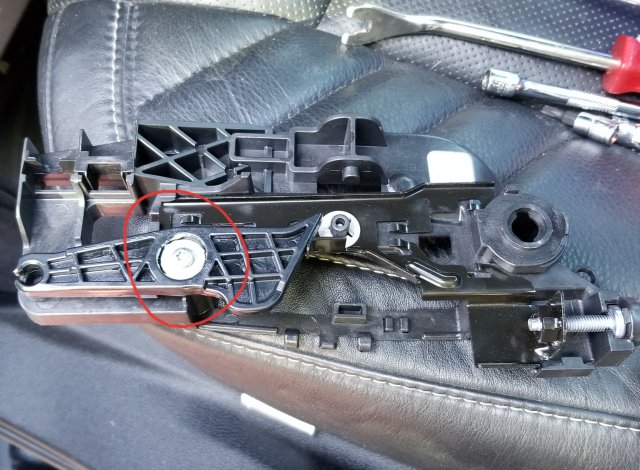

In my case, the rear driver door handle began to "skip", or not catch, all the time. Eventually, the handle would just make a crunching noise and not work, at all. I removed the outer door handle and found that the lever that the door handle actuates was "loose" and (in my not so humble opinion) had way too much play. I ordered a new DOOR HANDLE BRACKET:

Once I had the bracket, in hand, my suspicions were confirmed. The bolt that holds the lever in place, had the potential to back out... and it had. I decided to keep the new part, in the box, and figure a way to repair the one, on the car.

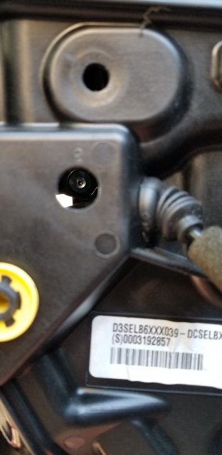

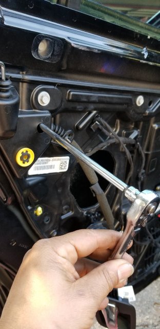

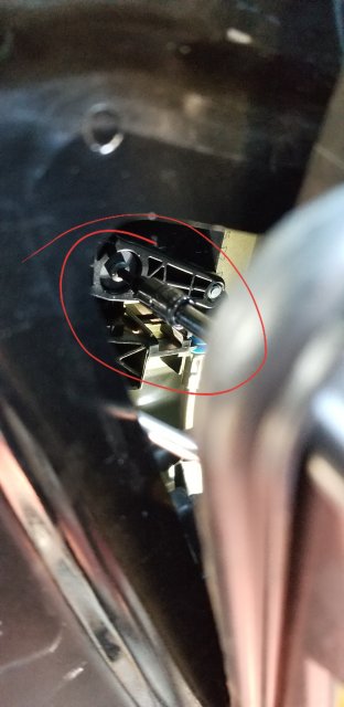

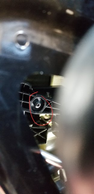

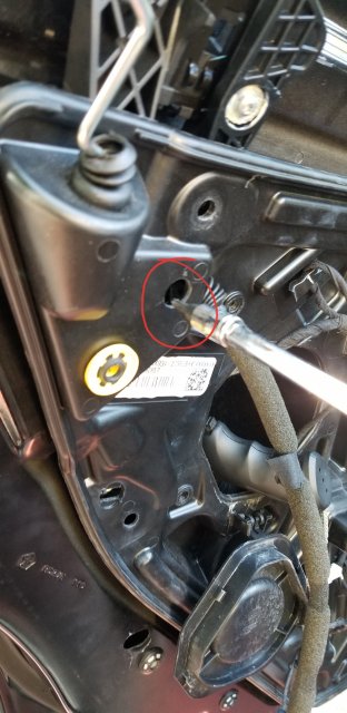

I removed the outside door handle. and was able to peer inside the door. I guestimated a bee line from the bolt, to the window regulator plastic thingy and marked it, with a Sharpie. Mind you, this is after trying to remove the window regulator assembly. I grabbed my drill (GASP) and drilled a 1/2" hole, in the regulator, where I had marked it. I put my flashlight inside the door and was able to look into the hole and see the offending screw. Using a 1/4" extension, I fished the Torx bit, into the hole and tightened the bolt. After replacing the outside door handle, it worked like a charm!
