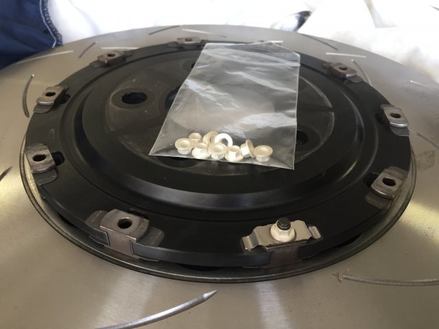

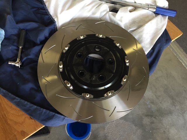

To begin with, disassemble each rotor, removing the hat, from the disk. You will need both ratchets, with Torx and 10mm deep socket.
My rotors were apparently built on a Friday afternoon. If my hardware configuration looks different, than yours, make a note and re-assemble the way yours are built. That's what I did.
Once the hat is separated, from the disk, you will want to remove the H-bobbins and spring clips. The spring clips slide right out.
I wire brushed the hat and painted it.
While that dried, I took a wire brush, to the H-Bobbins, to remove all the brake dust.
