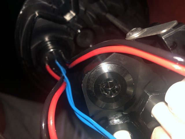

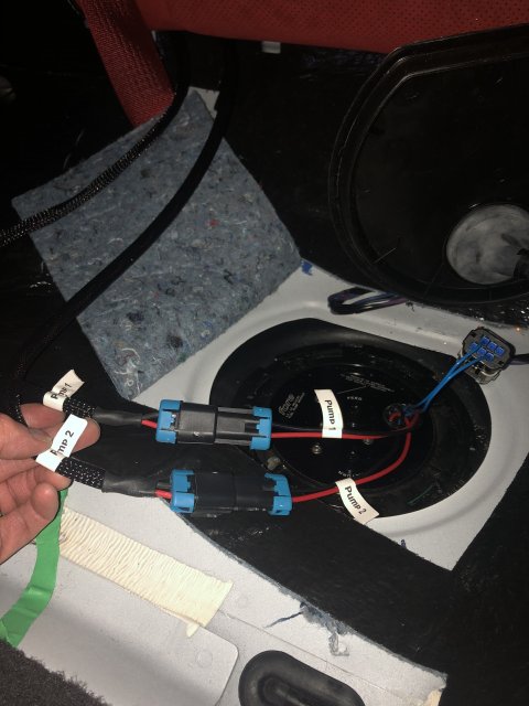

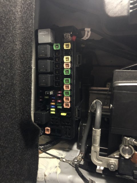

I’ll check and listen, but how can it be wired backwards? I can only see one way to wire it.
power on corner post of fuse panel
2 grounds on factory post beside fuse panel
Fist and Second fpdm and y harness only go together one way I’m pretty sure
pump 1 and 2 wires clearly labeled all the way to the hat.
wiring connector on the hat
am I missing anything?

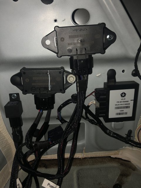

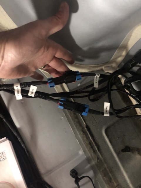

Checked the wiring again. Seems to be correct. Excuse the mess, I didn’t secure it all down yet because I wanted to make sure it was working first. The primary fpdm is the one with white line on it.

Looks like you have a plug and play harness... different than what I’ve installed in the past where a friend of mine had his connectors wired backwards. So, you’re probably right, they only go 1 way with these.
Did you disconnect anything else, maybe under the hood, that would be preventing it from starting? Pull a plug and see if any fuel is making it to the cylinders?
Im just thinking that even with the pump swap you may have done other modifications that could be at play here.
I imagine you have a way to read logs... are they showing fuel pressure at all?
