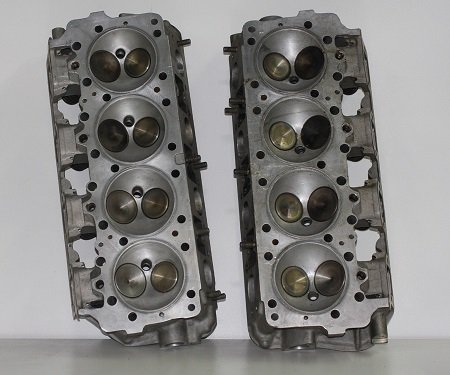

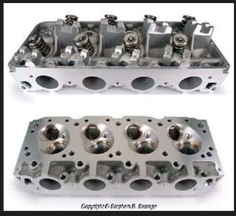

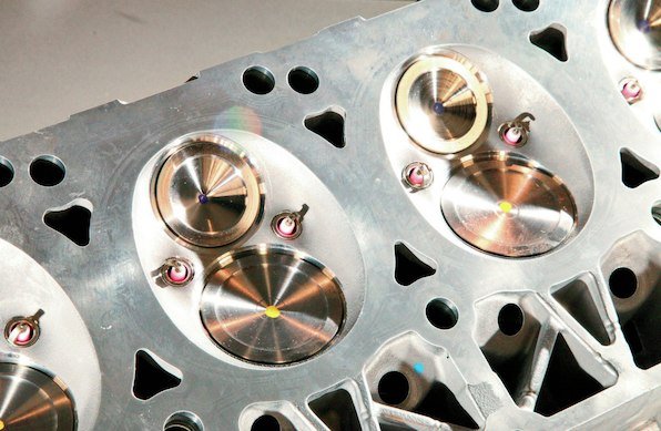

Agreed, modern "HEMI" motors aren't even hemi-spherical at all!
Somebody post up pictures of the two combustion chambers and it will be immediately obvious.

the basic design architecture of crossflow air path, dual rocker shafts, top-center spark plug(s) carries through. The Gen3 improves in several areas that technology advancement over the years revealed certain shortcomings of the Gen I and II, especially when normally aspirated.
16,293
86,381
Gen 3 is sort of a squashed hemisphere. Interesting that the Ford Boss 429 was similar. All had splayed pushrods and canted valves.
Gen II
Gen III
Ford
