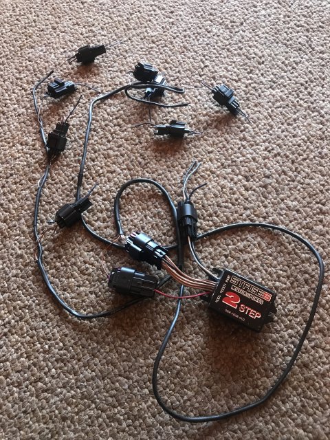

No. I was using a Stage6 Motorsports 2Step in conjunction with the transbrake in my T-400. They worked together off the same button but were independent systems. The point being that there wasn’t any issue using that rpm control with the factory pcm. I’m still going to be using that transbrake but the 2-step will be a function of the Holley EFI ECU now. EDE554BF-987C-449C-B90A-96302B1DEF79.jpeg

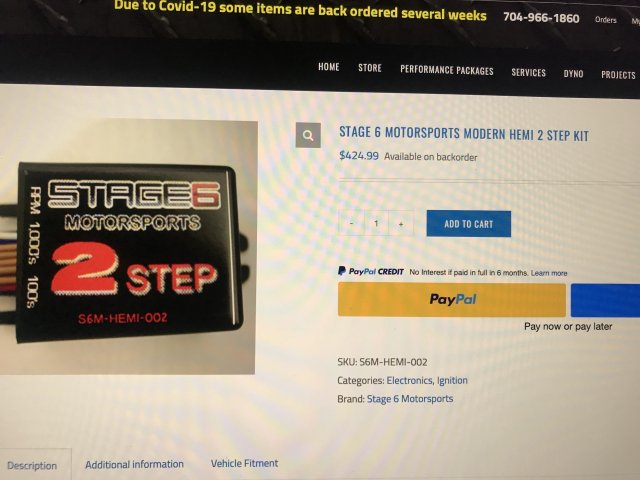

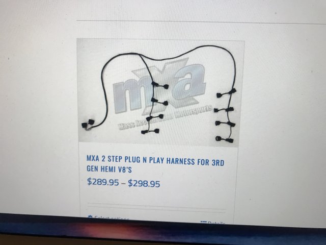

. The main performance advantage in having the 2Step/TB combination is the quick and consistent reaction times on the tree.
I have the 2-Step and plug-n-play harness that simplifies the installation that I no longer need. It worked perfect in my car. Retail on the Stage6 is $425 and the MXA harness is $300. I’ll sell the whole thing for $400 shipped. 2384CB80-1D40-4A4F-82A3-77BC14F82709.jpeg 741E9B04-48D4-47C8-95B2-7318C38735F2.jpeg
