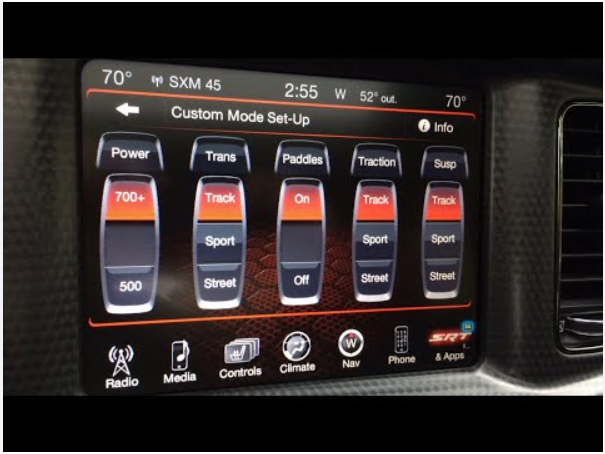

In addition to the red fob, make sure it is in 700hp mode. Even with the red key in your pocket you can override to 500hp on the screen.
I didn't realize there was a 700hp mode to switch to. I will look at performance pages and see if i can do that
Old style display, but yours should have something like this. Left button might be on 500hp?
