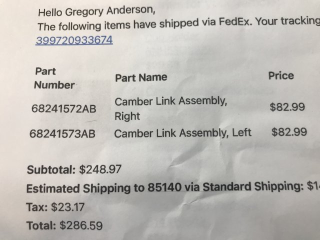

If most of you are like me you have a rear wheel camber out of tolerance on your Challenger.
I first encountered this problem on my 2008 SRT Challenger and the problem was there when I sold the car after 11 years.
I ran into the same issue with my 2015 Hellcat and 2019 Redeye.
The past several months I’ve been working with the new suspension technician at my dealership. Vince has been working on Mopar’s for 45 years. He did some research and found Mopar parts that we hoped would correct the camber issue. I didn’t want to say anything until we got the parts installed and verified with a four wheel alignment check. We completed that today and my out of tolerance rear wheel camber is now a thing of the past. Below are the parts if you interested. I got mine from Steve White Auto Parts.
