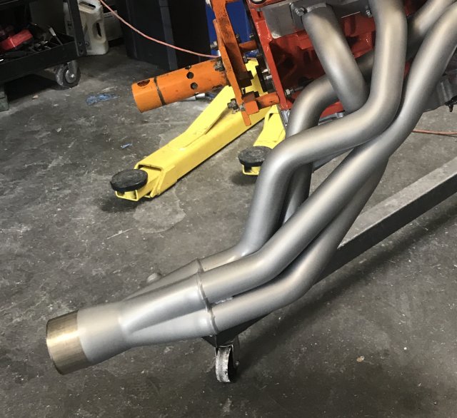

The stock manifolds are designed to work with the stock hp output of the engine. Replacing them with headers doesn’t improve on what the engineers at Dodge have built into the package. Mods that increase hp need to have adjustments made for that. Up to about the 900 hp point, the exhaust can be opened up enough by just replacing the stock cat pipe with one of the catless “off road” pipes. Beyond that.... headers are going to help. As far as heat goes..... there are things to help address that. I have my headers ceramic coated inside and out. That helps keep the heat inside the pipe to reduce radiation and it also help to maintain the exhaust gas velocity for increased power. B6C6BD93-2FF5-4613-A811-FA86E0FBA710.jpeg

The stock manifolds are designed to work with the stock hp output of the engine. Replacing them with headers doesn’t improve on what the engineers at Dodge have built into the package. Mods that increase hp need to have adjustments made for that. Up to about the 900 hp point, the exhaust can be opened up enough by just replacing the stock cat pipe with one of the catless “off road” pipes. Beyond that.... headers are going to help. As far as heat goes..... there are things to help address that. I have my headers ceramic coated inside and out. That helps keep the heat inside the pipe to reduce radiation and it also help to maintain the exhaust gas velocity for increased power. View attachment 20152
. Thanks... great Info!!!
