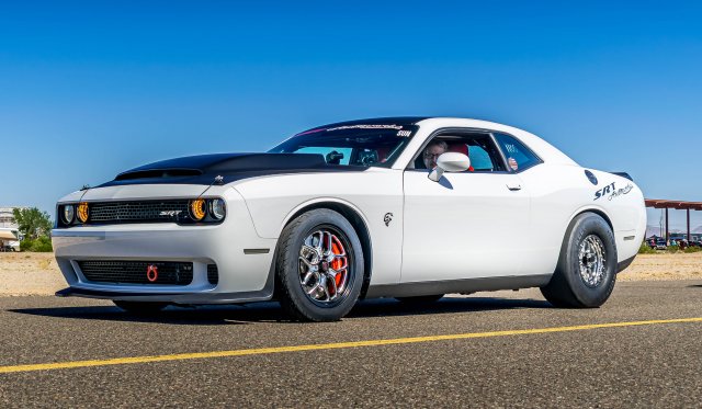

Went out to a track rental a week or so ago. Ran quite a few passes. Hot lapping the car pretty decent as well. I made around 15 passes.
I came to the track and just unloaded it the way I raced it in Ocala. Which is basically a street tune on the 4.5” pulley with a couple tweaks from Mario at Gearhead during the race. Car went 174mph in half on tune.
Ran consistent 9.6-9.7 with a best of 9.62 at 146 mph with a 1.55 60’
I cannot get the car to hook when I hole shot it.
I foot brake it and stalled to 1300 rpm, pause and wait for the last yellow and put it to the floor and spin.
I managed to baby the throttle and get a best of 1.49 but could not get further. When I gave the extra ass kick it won’t stick.
The prep seemed alright. A murdered out demon went 9.12 at 156 mph with a 1.26 60’ carrying the front wheels for like 70’. It was sick AF.
Anyways. The launch is a pain and not sure what’s up. My suspension mods are as follows.
