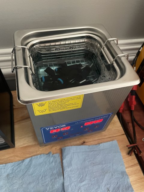

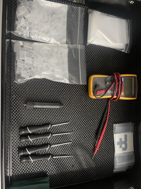

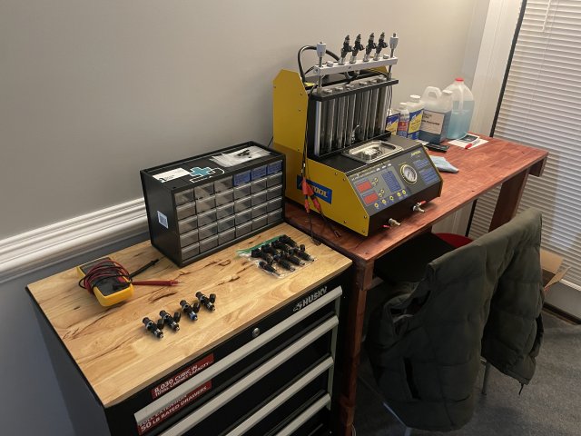

Just kidding, partially. Just wanted to give the community at large a heads up that I've been learning how to clean and service injectors. I enjoy it enough that I bought a quite sizeable machine to do the work, invested in fluids from Injector Rehab and Ultra-Flow and all parts to service your injectors. I'd like to offer this service to the community at large and I started Injector Cleanup (website soon!). I'm trying to do this right so I went the official route and got a nice shiny green vendor badge. I am currently able to service Siemens (stock Chrysler mostly), ID and FIC injectors. If you have other types/brands of injectors I will gladly service them but they will take a little bit longer to process as I don't keep the uncommon injector parts in stock (ID and FIC are Bosch just in case you are wondering) but can get them easily and quickly shipped.

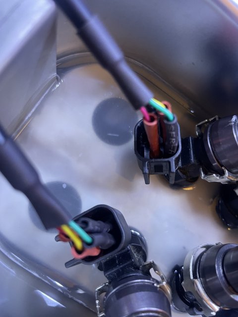

As a highlight what I do to service your injectors:
- Ohms check (gatekeeper check)
- Static ultrasonic cleaning in my bigger ultrasonic cleaning tub.
- Dynamic ultrasonic cleaning pulsing the injector in ultrasonic fluid
- Pressure leak check at 75 PSI
- Acceleration check x3
- High speed test at 43.5 psi x2
- Medium speed test at 43.5 psi x2

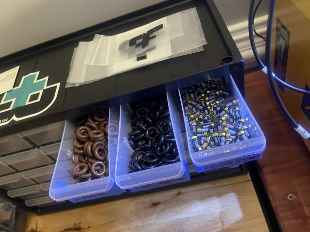

- All o-rings replaced
- Caps added if missing
- Bagged and indivi
Of note, if an injector fails the OHM check (reads 0L) the injector will be marked as unservicable and the client will be notified immediately. Here are some pics of my humble setup.
