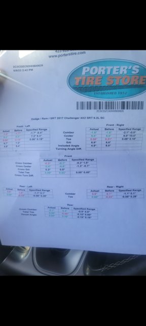

What does your camber look like in the rear?
You've got a lot of power, you're not squatting down on your inside tire edges and loosing traction are you?
