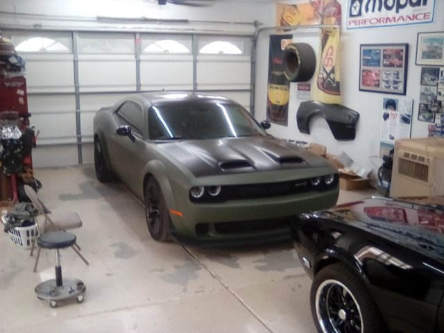

My Redeye is a factory black car with the factory " black graphics package" option. I did a full body wrap at 100 miles. For $3,500
Including wrapping the black graphics, IMG_20200907_131639.jpg hood, roof and trunk.
Very easy to clean, no waxing and no issues.
Thats interesting when I was reading about matt vinyl on the internet people seemed to think it was difficult to maintain. I love green cars in all shades, yours looks great.

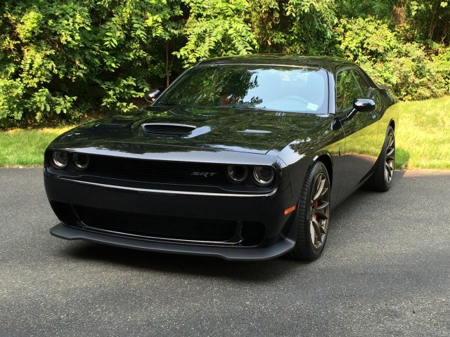

I've posted this pic of my 2015 Phantom Black before. After paint correction and CQuartz ceramic coat it reflected like a mirror.
It was easy to keep clean (especially the wheels!) and made a black car livable.

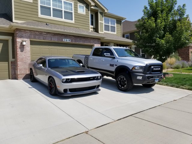

Ceramic coating won't protect you from larger stone chips, but does wonders for maintenance.
I have the bottom half of the car wrapped along with the front, and then CSL on the upper half.
And mine's not a DD, if it was, I would certainly have the lower wrapped, even with the incredibly low mileage I've got (4700ish over 5 years), I've got impacts in the lower wrap that would make me cry if I didn't have the wrap.
Oh, and I also have the Mopar mudflaps too. They have taken a real beating that has saved even more damage from landing on the paint.

My .02
They look a nice pair together, loving the Ram. Wow, that is low mileage, I thought 20K miles in 5 years on one of my cars was low.
