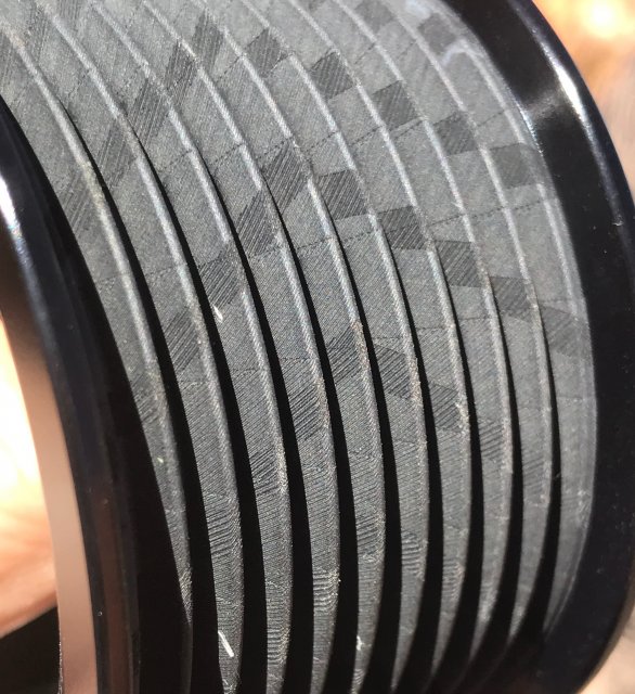

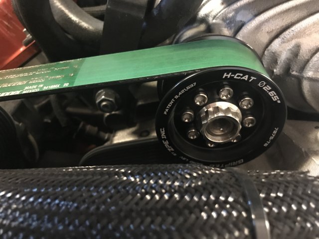

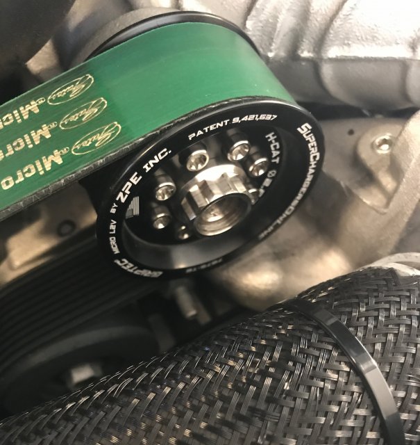

I was running 2.65 Griptec on my 900 whp Challenger and wondered why anybody would use anything else. Every Metco pulleyed car I ever rode in had belt squeak. Very annoying. I was running that 2.65 with a +10 ATI and never had any slip, dust or noise. In other words... it didn’t slip. And that was just using the stock tensioner without a additional idler to increase belt wrap. The surface may wear down over time but I didn’t experience that due to not putting a lot of miles on the car. As far as the quality of the hub and pulley combination.... there is nothing better. 5A442F77-81BA-485F-9CC0-29E75E2F92AB.jpeg EB14C23D-38D8-4CC5-B84B-9415534E21AF.jpeg B6E57FD5-1419-4922-91BD-BE85CEA79FAC.jpeg

I actually have a set (2.65 and 2.85). That is one hub and two rings. All in like new condition (in the pictures). I will sell for 50% of whatever retail is. Only “but” is they are at my shop and and I won’t be getting over there until mid December. I forgot to bring them home with me so I’ve been holding off listing for sale until I have them.
