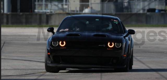

Someone asked a while back about what exhaust I was using in this video at Sebring.
It is a Solo Performance cat back system that has an X-muffler in place of the OE two muffs and the 3" tailpipes have J-pipes to minimize drone. I installed some double-barrel SS tips on the system. Only issue was it cooked an active exhaust valve actuator on track, threw a code and I had to have the valve replaced (under warranty with OE exhaust back in place). I had welded valves from another system in place, so still had the OE system. Definitely sounds different, a little more old school musclecar. I would encourage you not to cut up your stock system if you go aftermarket and need these valves. 20220713_171630.jpg Merry CHRISTmas, hope to see ya'll on track soon!
