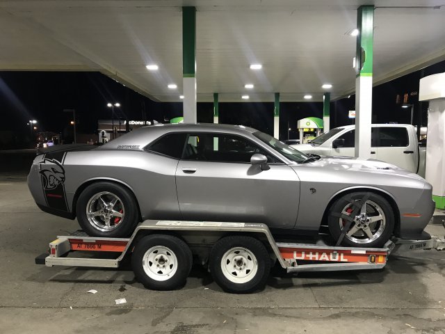

I’m loading mine up on a uhaul car hauler lol, the wheel covers in the hauler fold down so it’s easy getting in and out E6EFB0CB-FDA4-437D-9B8D-B04F050895CA.jpeg

^^ would it fit if she had bigger hips?

hellno - I saw a NB Challenger at Beech Bend 2 wks ago on one of those trailers. It looked like it was using up most of the room. I'm pretty sure my rear tires would rub the outer rails.

I was at beech bend the past weekend

Just go to a u haul and measure it
