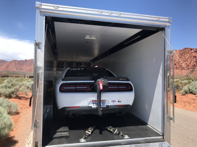

20' is definitely too small. While the car will physically fit, you can't get the right CG with the car/trailer relationship, at least with a "standard" 20' trailer.
24' is minimum in my opinion, which is what I had. This is big enough to get the car in correctly, and then you have room up front for some fuel, tires, etc.

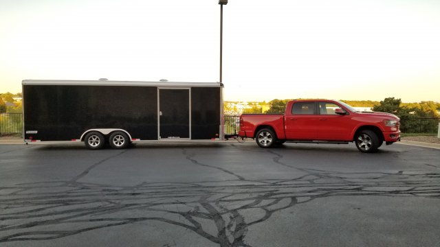

Depends on a number of factors starting with the truck. I had a 20’ enclosed cargo/car hauler and it did the job ok. I didn’t have any issues towing that with a 5.7L 1500. When things started getting serious I decided I wanted a larger/optioned trailer and started looking at loaded 24’ models. The weight with the car and race car related cargo pushed the towing limit on that truck past it’s rated limit so I decided I needed 3E82A183-1DAD-46C2-B8E8-4A74CC91C28A.jpeg a more capable truck and stepped up to the 2500 Cummins. Now the weight of the trailer wasn’t a issue any more so why not go with a 28’ instead! I’m happy now. Except those 32’s look really nice. 😂

That is one sweet trailer. I do have a Dodge 2500 diesel so pulling will not be a problem.

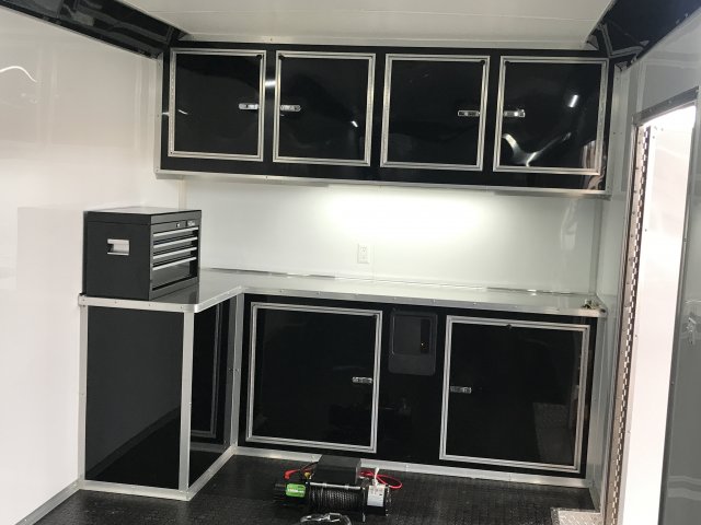

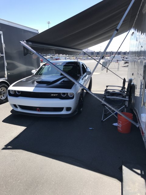

Then it’s all about how much you want to invest in a trailer and what kind of storage options you have concerning size. I can’t store anything at my house so I have to use a storage facility regardless of what kind or size of trailer it is. That being the case for me... size doesn’t matter. One of the things I have seen is..... good luck in finding a nice used race car hauler at a decent price. If a well optioned new one is well maintained and taken care of, you can expect to get a good percentage of your money back when it’s time to sell. I decided on the 28’ because it didn’t cost but $1000 more than the 24’ and it not only gives me a lot more room in front of the car to work with but the resale will be better when the time comes. If all you’re doing is hauling the car to the track and back for open test and tune stuff then all you need is transportation. If you plan on racing where you are at the track all day and the trailer becomes your pit, then that’s another thing. I optioned mine with a generator/air cond. and a awning. If you go to race and experience spending all day at the track in the sun..... good luck in getting the wife or anybody else to go with you more than once. Here’s mine.... 26929487-3BE8-4827-88C6-8A65A8B8F6D0.jpeg B732B08D-7217-406D-BA76-64A2F03A288A.jpeg F66F786F-B171-4AE2-8077-A5C409BB79A9.jpeg C258282C-D32D-487A-AFCD-E88DF45DE58C.jpeg 0E53304A-31A0-49B9-88E8-E5BBE023EE5D.jpeg 31D8064A-902A-4F6C-B4E6-CFDBAFBE6F07.jpeg 1B3E5E93-6947-4FC9-832F-05D3C5E1133C.jpeg 8FF29267-E01A-4758-901D-55749E427184.jpeg

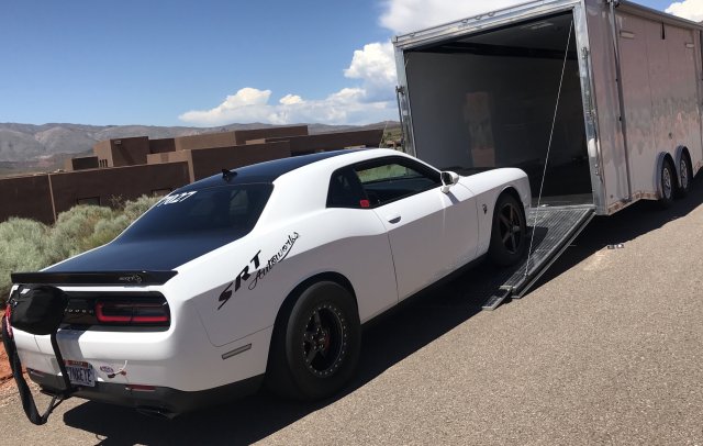

They do make them with that. For low cars like ours, they need to also have a removable wheel well to get the door open. It just adds to the cost. The more expensive trailers do offer that as a option. I don’t have one in mine and have found that loading the car with the winch is so easy (and safer) that I don’t bother to drive it in any more even though getting in and out is something that I can still do.

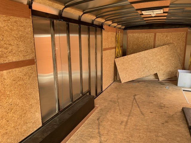

I am frankenstiening my trailer right now.

Is that a 26’? Look forward to seeing it finished.
