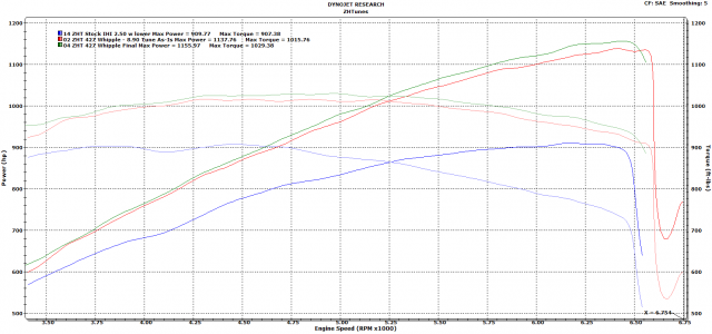

It may be a surprise to some folks, but I never had a chance to dyno the new build before I ran the 8.9's last week. After making several 8 second passes, I decided to change that fact and see how much power she's making.
The 8.90 tune as-is made an SAE corrected 1137 WHP and 1015 torque. After a couple tweaks, I ended the day with 1155 WHP and 1029 torque.
Dyno Vid:
Here are my dyno results comparing power made on my previous stock motor setup with a 2.50 + lower versus the built 427 Whipple I'm running now. ZHT Pullied Hellcat Blower vs 427 Whipple.png

Congratulations, is this the race motor whipple build? As I recall 428, right?
cole3986
#1028
1,106
1,454
TBD
Sorry, just looked at the bottom of the dyno graph, 427

Was the stock blower on the same 427 longblock?
Great work!

No, my old build was a full bolt on stock sealed long block with stock unported IHI supercharger.
