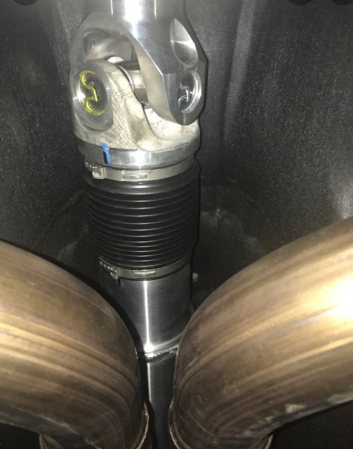

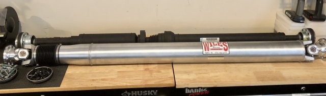

Is there a driveshaft made with a splined shaft that allows fore/aft movement of the DS? It seems that I remember one (possibly Wiles?). There are people wanting to consider the 4-link rear like I have but want to stay with the A8. The 4-link needs to have some fore/aft DS movement at the trans and that requires a splined slip shaft somewhere in the connection between the pinion and the trans. Anybody know if that is available with a hp90 shaft?
