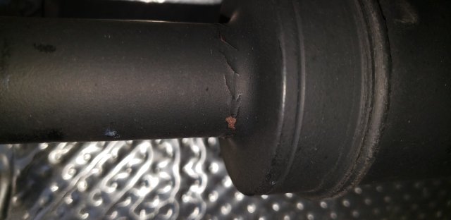

Anybody seen something like this before b 20220317_185324.jpg reaking a driveshaft?

Wow nope!

It has been that way since my best of 10.55... so I assume it has turn as far as it is planning to! Hope your SS is all you hoped!

Is that just peeling paint maybe??
Since you still have warranty make them look at it close.
You could see if a exacto blade goes into the crack?

Looks like it’s starting to get twisty

Thats twisted which is why the paint looks like that. Probably fine for now but the next hard launch might snap it. I would just replace it with a CF one. Every car ive ever owned in the last 10 years has a CF DS except the VW and it makes a huge difference!
