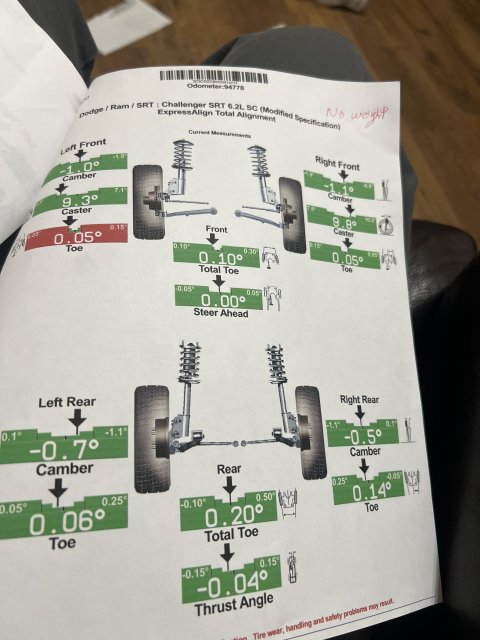

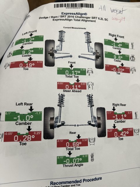

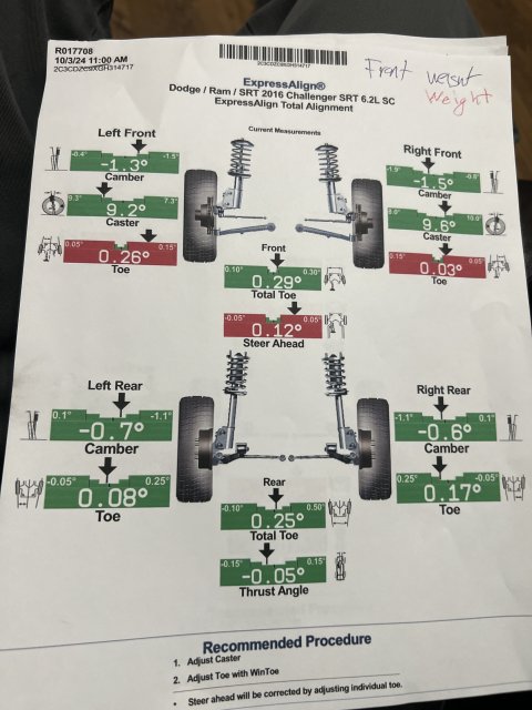

He did four readings. No weight, weight on entire car, weight on front, and weight in drivers seat.
Say what now? I want to learn don’t get me wrong. Which one is simply the car on the floor? If that is the all weight that rear toe needs to get adjusted big time. Then what is front weight? Why does the front toe move around? One side much more. What do you have for a suspension? Interesting diagrams something is up.

So the one with .05 on the left toe is no weight. One red block. I do not know what they mean by front weight. .26 on drivers side. All weight is .19 on toe on drivers side. .25 is driver in car. .25 toe on drivers side. In front upper aad arms and the rest is stick. In the rear a lot of bmr stuff and a cradle lockout.

Would this mean that something is loose? But I would think they would see that.

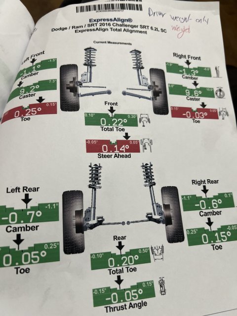

I notice with the reading with driver in the car the left toe has a positive reading of .26. That is not good! Possible tie rod being bad or needs adjustment. That causes instability.
