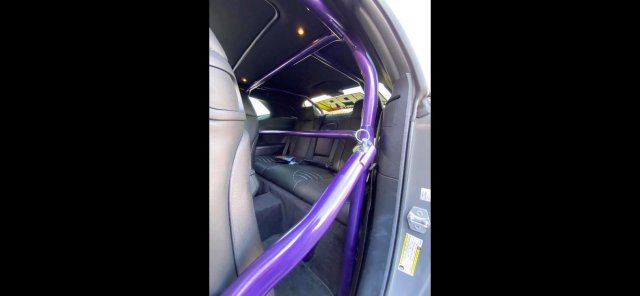

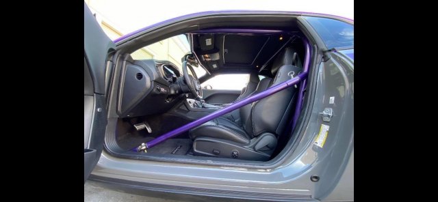

Where are you located? Shop in Calif does beautiful work at a fair price. C6717495-8C2C-448D-BB9D-6D0517ACFA82.jpeg 006546A6-7688-45C3-88B9-294E39A6D980.jpeg

That looks fantastic. Couple questions:
What was the cost?
I am assuming that is completely welded in?
Did they remove quite a bit of the interior? Interior reinstall good, and blemish free? No broken fasteners?
I was actually wanting to do an 8 point, but very hesitant on removing the dash. Can you pass along the contact info for them. Want to talk cost and timing.
I am located in Temecula CA, by north San Diego County.
Thanks
3,611
11,634
What was the cost?
Thanks
The shop that did that cage (it’s in a new Redeye) is in Calimesa CA just north of you. It’s a 10 point Tig welded Chromoly cage, NHRA certified down to 8.5 seconds. I just had them fabricate a custom drag wing on my Challenger and the owner (Jason) told me that that cage is $5500. Of coarse something like this requires that the entire interior including the dash and windshield be removed, but that’s what it takes to do it right. When finished you can not tell it was ever done. That price is a bargain. The shop is Carlin Fabrication in Calimesa.
