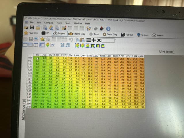

Surprisingly it does not have a ton of timing. At a cylinder fill of 1.5 or so around 18. And it goes down quickly after that as more pressure in the cylinder cannot stand even that timing. In order to download the tune you need to download the latest "beta" version of hp tuners.

This is the factory tune I was able to download. But I mis spoke. At a cylinder fill of 1.64 or so it goes up to 20. There are many more tables with higher cylinder fill that go down to 18 or so. So, lots of timing on the stock table from the factory.

Here you go!

Would have to log to see how much cylinder fill you are getting. Probably much more with the 3.0 than the 2.4. I am sure there is some safety built in with the timing as you see it go down to as low as 9. Whether you get to that point a good log down the 1320 can tell you. Probably in the higher cylinder fill you can add about 2 degrees in that area. But there goes your warranty on a 120k car.

Back to the original subject. You can log on the demon 170! to see your aircharge.
And as the other forum member stated I doubt timing is maxed out.
Dodge has to warranty these cars and quite a few of these engines seem to have been replaced already.
But I doubt due to excessive timing as I do not see it in what I posted.

20 degrees on e70 seems like a lot to me. Especially with 1300 injectors. I'm running 3 pumps, 2200 injectors e85 and we keep it under 18 degrees

I think the 20 degrees quickly goes down once past the 1.5 or so cylinder fill pressure. But at that point of the tune you are correct as compared to what a lot of tuners put their customers timing at. Mine is at 20 set by my tuner and goes down to 18 in the high torque areas. I remember the reverse bell shape being the model 10 to 20 years ago. More timing under the high torque area going down on the high torque area and then ramped up again in the high rpm area.
