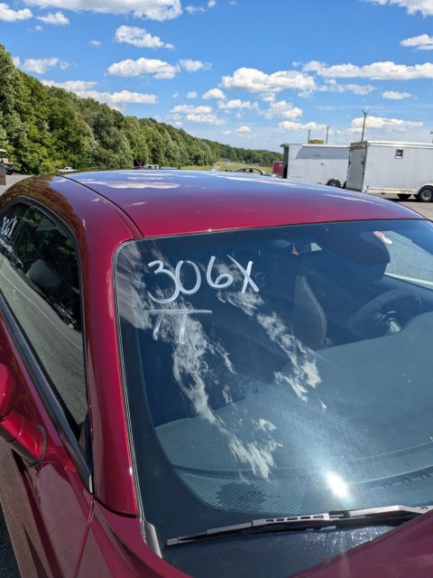

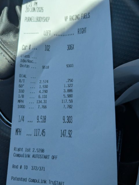

Based on Ron's recommendation, had the local Dodge dealer install the tune on Friday, went to Cecil today for test and tune. No or very little prep, greasy surface and 84/85 degrees. Spinfest launching on 1st gear so launched in 2nd gear. 9.30- the tune is good. Stock car.

WTF were you racing .. 1.9 60 and a 9.5 at a crap MPH?
And nice run

That is 3 different tracks approximately100 foot wheelies.1.32, 1.34 and 1.35 sixty on the back tires. The car would NEVER do that before. It also did 1.20 sixty foot twice at 2350 and 1880 DA. It would NEVER do that before. It's crazy.

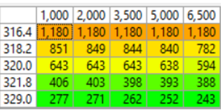

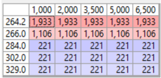

I need to find a copy of the new cal to compare to original. Glad it's working well.

Thanks! I'll run a compare against the original and see what I can see and report back.

I'd love some screenshots of parameters

we are not special enough to see the new calibration let alone the old calibration
