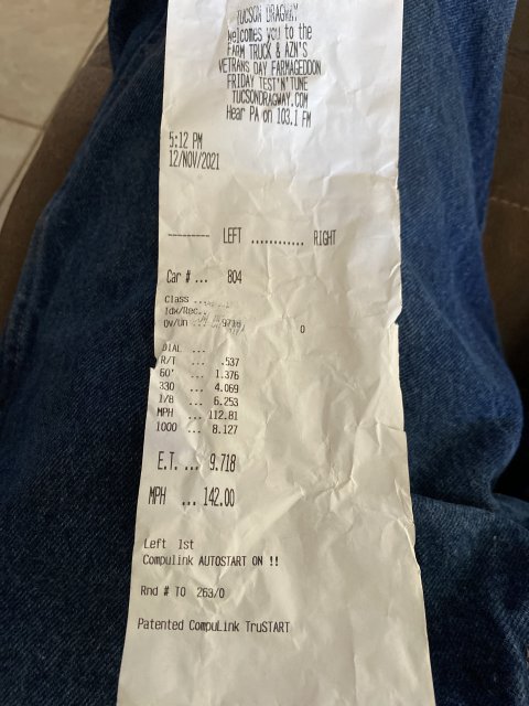

I have a great new tuner! I will keep that confidential at this time. So I ran with farm truck and arm. Got my younger 15.5 yr old daughter a slug bug shirt which they both signed. Now the run that got me kicked out.
1). At 5400 feet I ran 9.71 at 142. There was no other car or truck as fast as me. There was a towed ninja bike which ran 9.71 at 138.
I got a 1.35 sixty foot.
2). My tuner read some logs. With a 10 percent lower and 2.5 upper I was only making 14 psi. The sc is original and probably worn out. He said the kpa was only 200 whatever that means.
3). So he is having me add one degree of timing. But I am going on vacation and can’t log for him for two weeks.
I think I may keep it Mopar and go with a 2.7 and a ported top.
I am sure I could of done a 9.6 as when I ran at 5 it was 83 and it cooled down to the high 60s. Just weird only 14 psi.
