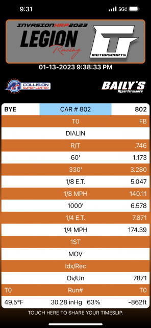

Originally posted to show a race versus someone I thought I raced but turned out to be someone else, one of my clients actually from California in his Demon. So I'm changing the purpose of this thread to show some vids of me cutting 1.1x 60's and maybe share some info on how I do it.
So here, I'm testing a small shot of nitrous, 150 shot with the 3.8L Whipple getting data so that I don't do a crazy wheelie later when I decide to turn it up.
Having a lot of power to work with helps, at least it helps me a lot. Tire, suspension, and radial track prep are the other critical pieces that you must have.
I use MT ET Street Pro 315's for my tire, BMR suspension rear arms, their solid bushings, and Menscer coilovers through Reed Motorsports.
If you pick BMR, their single off car adjustable arms are stronger than their on car adjustable variants and ever since I switched, I haven't had any issues.
The other brand for rear suspension parts, AAD, is good too and very popular but they weren't around much when I got started and what I have works for me so I never had a good reason to make a change.
More vids to come, of 1.18, 1.17, and 1.16 60's will be posted later.
