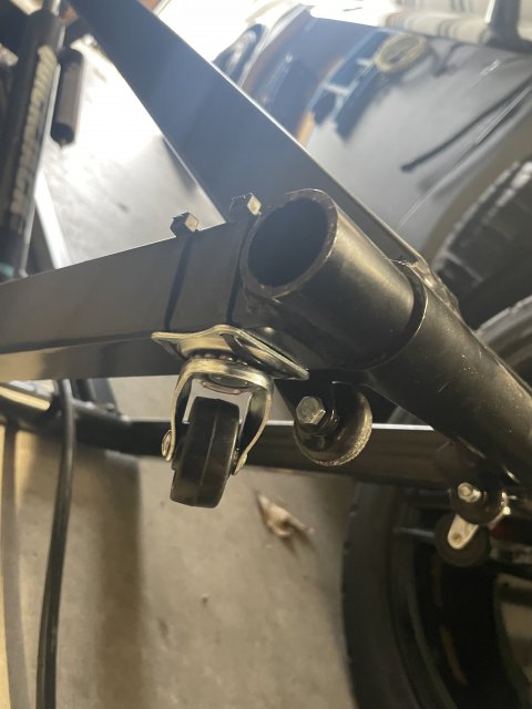

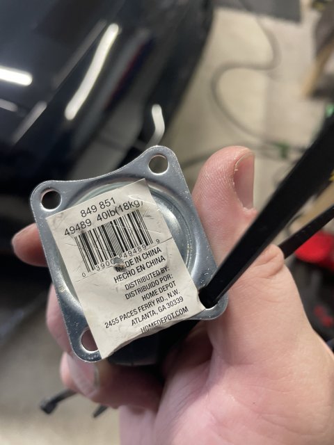

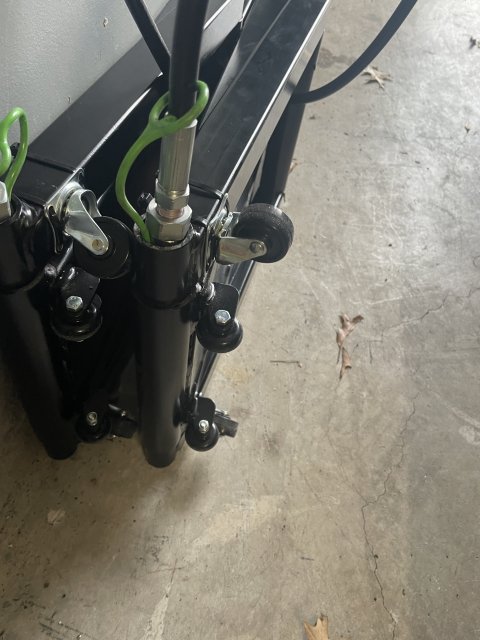

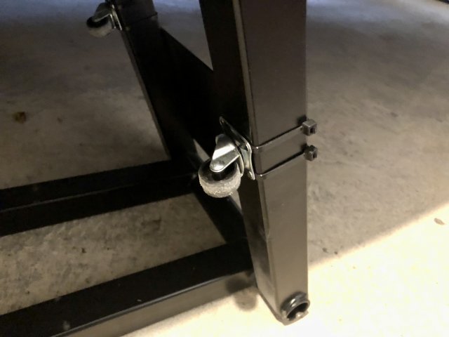

Pushing around the lifts on my 7k model gets old quick so a quick YT search revealed the following:
Simple mod that cost me maybe 15.00 in cheap casters. Casters are not the best but still swivel and roll good enough.

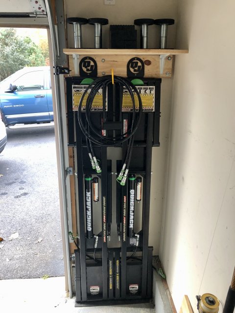

This is how I store them, which is a pita depending on how my back feels. 8B3BCF78-57BA-4545-A375-69AD2C0668D9.jpeg

This is how I store them, which is a pita depending on how my back feels. View attachment 60112
Yep, my problem also. Store them vertical to save room. Mine have little wheels on one side, so dragging them is a PIA but the little wheels make it a bit better. They are under the Cat until it gets driven now. I was amazed on how much more easy it was to maneuver them and plug the hoses together with the shoulder repaired!

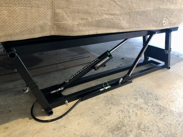

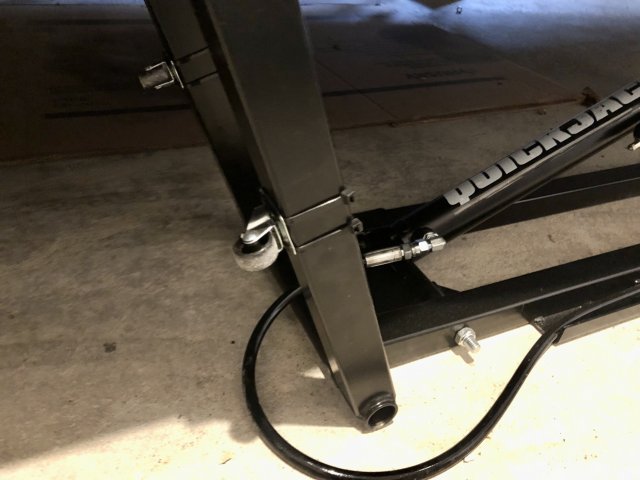

Just did this myself today so much easier to move!
2E48C4C8-0D42-418B-B5FC-D9B0291B151E.jpeg CF4958B1-D4BC-4259-938A-5AE927A8C38B.jpeg DCCD342F-5A0D-495B-8E8A-445D86B614C1.jpeg
I dont have these but looks like from your photo there are already wheels provided, they're just too small and rinky dink. Is that right?
