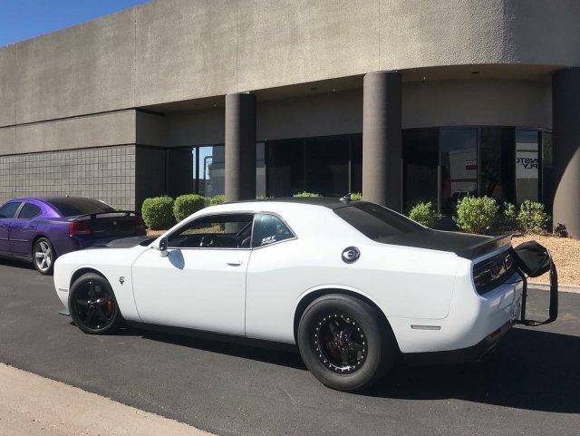

I was wondering if they would clear the calipers. Thank you.
Depending on the wheel backspacing you may have to use short swaybar links. That is no big deal, they are cheap and easy to install. I would not give up the added big tire choice (315/50-17) to save the cost of short links. You need as much tire as you can get on these things. 00DD55EA-F09D-4FE8-84EF-2053E99033CB.jpeg

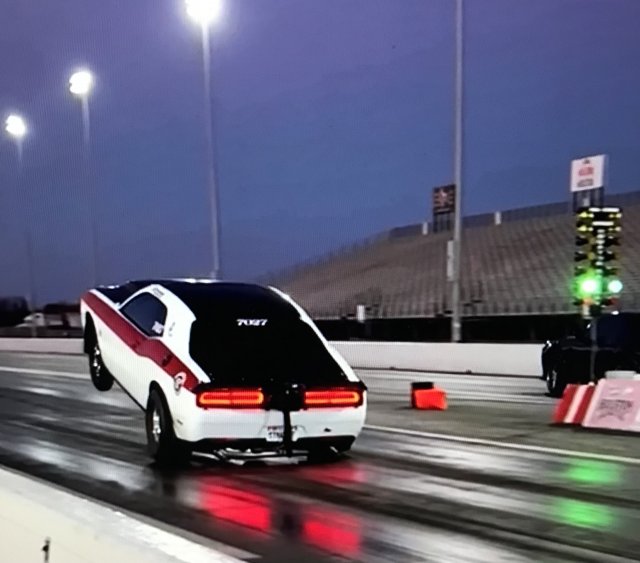

2023 Challenger Hellcat Jailbreak Widebody
Thread Starter #17
Depending on the wheel backspacing you may have to use short swaybar links. That is no big deal, they are cheap and easy to install. I would not give up the added big tire choice (315/50-17) to save the cost of short links. You need as much tire as you can get on these things. View attachment 96992

Marc has much more experience than I do. I just switched to the 315 50R 17s this week after running the 18s for 3 years.
3,505
11,288
Thank you. Bad looking machine and I see that you have the 150-mph required chute.
Haha. A little more than that at this point…. 433B8EF0-EC49-493D-8F62-1504486B8BC8.jpeg 417C2DAF-48B0-4CFD-8EFA-E63726DD9FEB.jpeg
