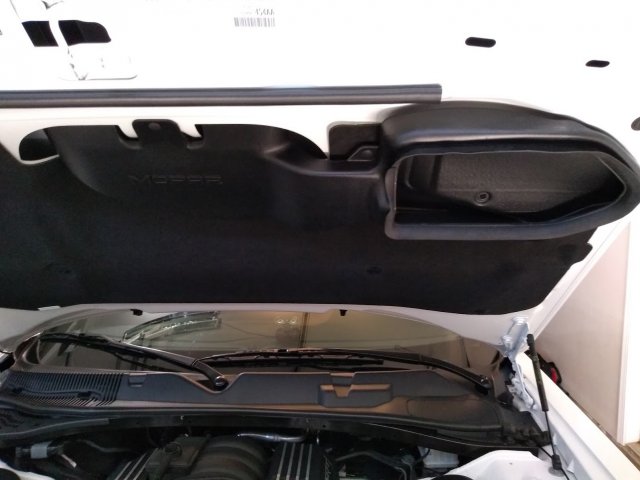

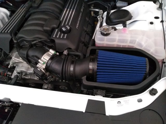

I put the T/A CAI kit on my 1320, but if I had it all to do again I would put the Hellcat airbox and plug it into the headlight. I noticed the biggest drop in IAT after I was able to get that extra ram air from the headlight and the center scoop (the T/A kit ties into the scoop as well).\
Here are pics of what it looked like after install.

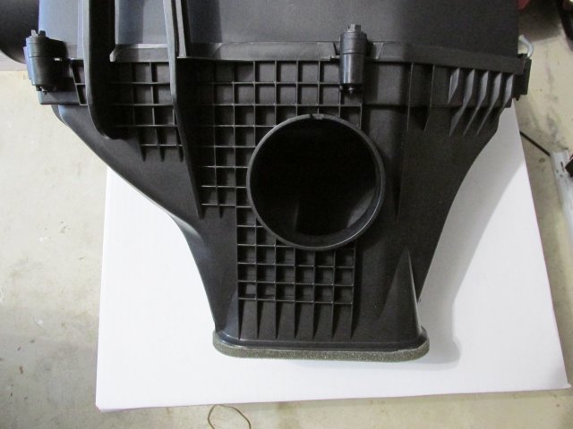

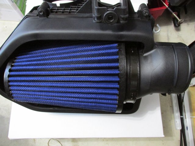

and the airbox

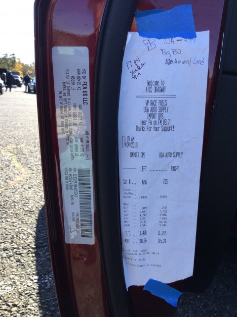

11.428 bone stock engine, on 18x10 DR’s and front skinnies, rear seat delete and no passenger seat, with HC air box & felt tube.
Frankly, save your $ on the CAI and use a hole cut saw and fabricate your own tube.

yes....the T/A box does have the hole in it. The T/A kit comes with the bigger airbox, the headlight duct, the open airbox top with the big cone filter, and the air duct that goes to the center scoop of the hood.
The 1320 does not come with the big airbox, it does not come with the headlight duct or the headlight open for air to get in (it is capped on the inside that you have to remove, but doesn't go to anything since the 1320 airbox does not have a side opening), it does not come with an open top airbox. It comes with the regular closed airbox that comes on every other Scat Pack Challenger. This was yet another performance item that Dodge did not give us on the 1320 for a drag oriented car, when they clearly had the parts on the shelf.
I could have bought just the Hellcat airbox and the headlight air duct, but I was bedazzled by the T/A setup and just had to have it.....so I got it....for slightly over $400. If I could go back in time, I would have gotten just the Hellcat airbox and headlight duct. The items in the pics above are the items from the T/A kit.
