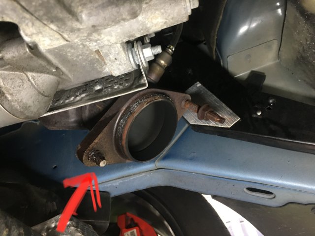

As the title states boys. I snapped one of the studs while removing my exhaust to do a 3.90 diff swap on my M6 Challenger.
two questions.
1- does anyone know if those studs are pressed in or screwed in?
2- if pressed in, anyone have any pointers on how to press it out WITHOUT taking the header off the car?
I think they are screwed in because the end of the stud has what looks like and external torx end on it which I assume is there to aid in install and removal of the stud.
I appreciate any help you guys can give me.

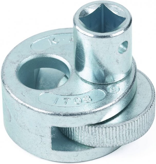

Put the heat to the flange not the stud. The idea is to expand the flange around the stud and then use a pair of vise gripes or a stud remover like in the picture. There are a few different types of stud removers available as well. If you use vise gripes, work the stud back and forth as it comes loose. Don't just reef it out as it could break.
I need one of those

I'm gonna soak it tonight when I get home from work and let it sit until tomorrow. I"ll try it with vise grips first. If they don't work out i'll get me one of these stud removers you posted or one of these
