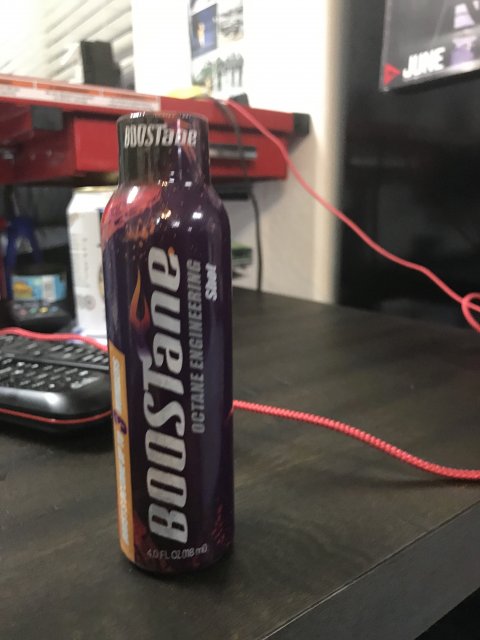

What size can? I use the Boostane 4 oz shot cans.

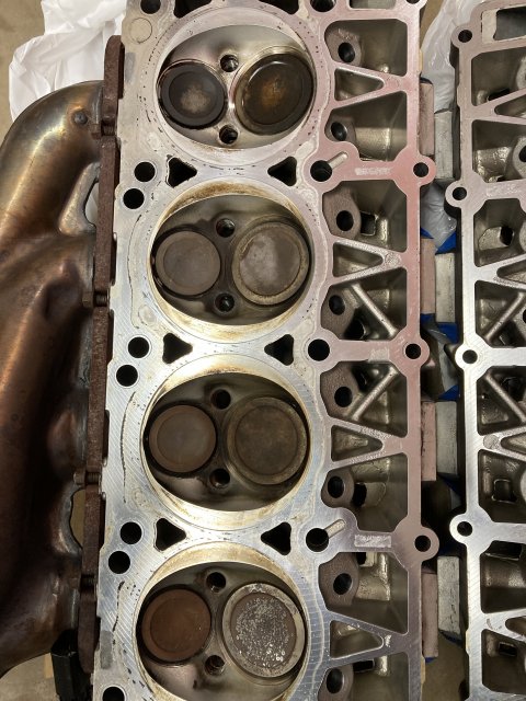

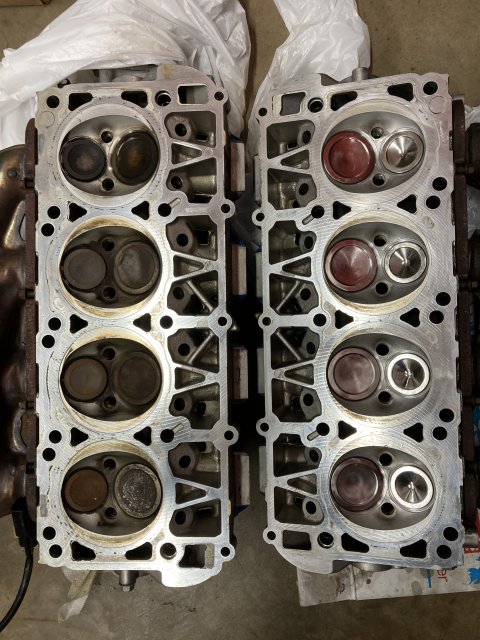

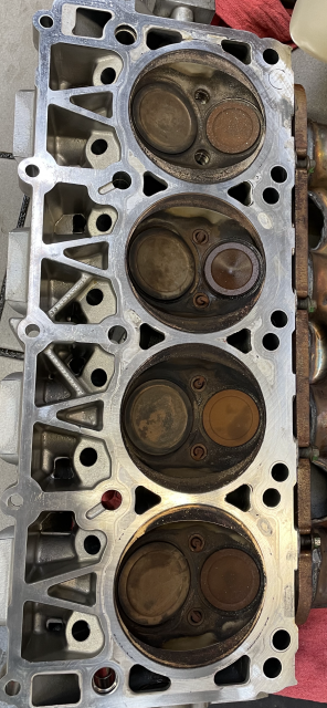

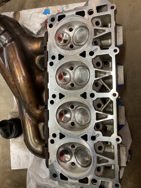

There ya go. Wonder what the ppm is vs adding some additive. Mike's pics don't lie that 32oz in 18 gallons caked up the exhaust valves.
Yep, it's the amount used that's the biggest problem, maybe over time it can build up on valves anyway but 32oz per tank is excessive. I use 2oz to 8 gals. to go from 93 > 97 octane & don't notice any orange on exhaust tips, have not had the plugs out yet to see there.

That looks pretty enough to drink P.
Let me know if it taste like grapes. I like grape flavor:p
4,847
25,745
It tastes like VICTORY!!!
5,205
9,661
Smells like grapes :LOL:
