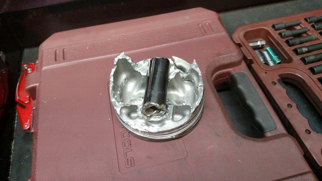

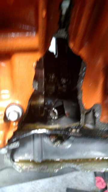

Wanted to break this out since there's been so much discussion. I had a performance shop reach out to me over the weekend. They've had three Hellcats fail all around the 800rwhp mark on a Mustang dyno, all cylinder 7 like mine. They've had one Demon fail, 910rwhp from their Mustang dyno also cylinder 7. They've now started to recommend pistons/rods at anything over 800RWHP.
