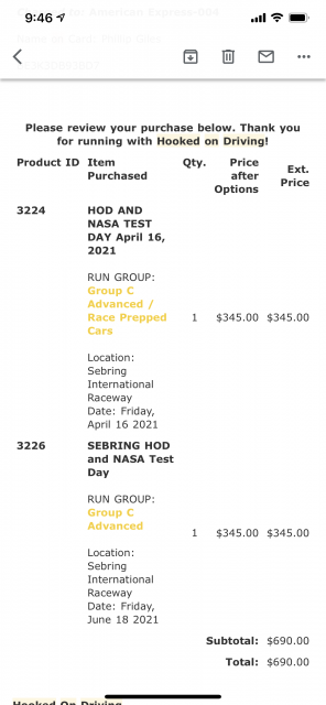

So if I want tires for a course like Sebring but are usable around town is the answer Michelin Pilot Sport Cup 2? Talked to a rep there and that was his reco but he doesn’t rep for other manufacturers. My Dodge tech also highly recommends Michelins. Any thoughts on stock 2019 Redeye wheels for track days? Finally, when looking at the 305 20s for the Michelins I see several variations that say Ferrari, Jag, etc. Which would I choose?? Thx!! C0590B1F-617C-4F00-8AA5-21644BC14479.jpeg

@Rcasa20 Rico, when are you going to Sebring?
I’m signed up for two track sessions at Sebring.
No date yet. Need to get my tire situation settled and will keep you posted.
sign up with hooked on driving.
pick one of those dates and we can meet up there. I can help out. I have a whole trailer rig setup for road racing. Got you covered.
