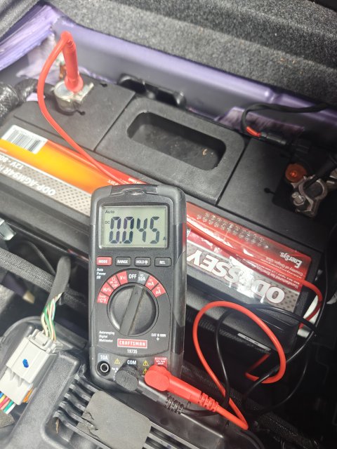

Hey everyone, I’ve got a parasitic battery drain issue on my 2016 Dodge Challenger Hellcat.
Here’s the journey so far:
The car sat for about a month due to winter and snow. When I tried starting it, the starter barely turned—no crank. Dead battery.
I attempted to recharge the original OEM battery, but it wouldn’t hold any charge at all. So I replaced it with an Odyssey AGM battery.
Now, after installing the new battery, and going for a nice long drive, the following morning the battery was dead.
I charged the battery up again, went for a long drive and let the car sit overnight. This time though, I disconnected the negative terminal before going to bed to see what would happen.
I confirmed that when the battery is disconnected (negative terminal off overnight), it holds charge fine.
Next, I suspected the RF hub may be the culprit so I pulled fuse 33 and let the car sit overnight, but the next morning the drain still happened.
I also disconnected the negative terminal and ran the multimeter in series, which showed around 4 milliamps, which is normal.
Next steps:
1) I’m planning to pull one fuse at a time overnight to isolate the circuit.
2) Check Alternator by charging battery, disconnecting the alternator and ketting sit overnight. Any advice on common parasitic culprits in Hellcats or tips for speeding up this process?
I have no major aftermarket parts on the car, just a Legmaker intake and some black badging.
Thanks in advance!
