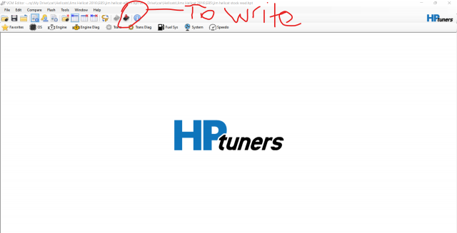

Download tune then hit the red write button

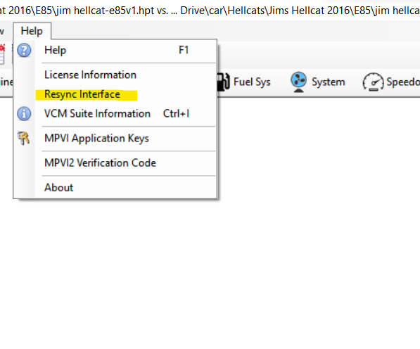

If that doesn't work you may have to do a sync

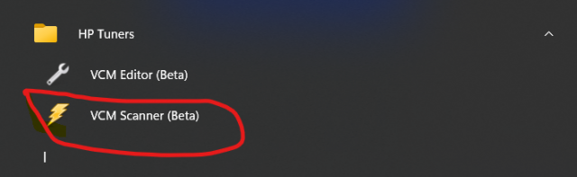

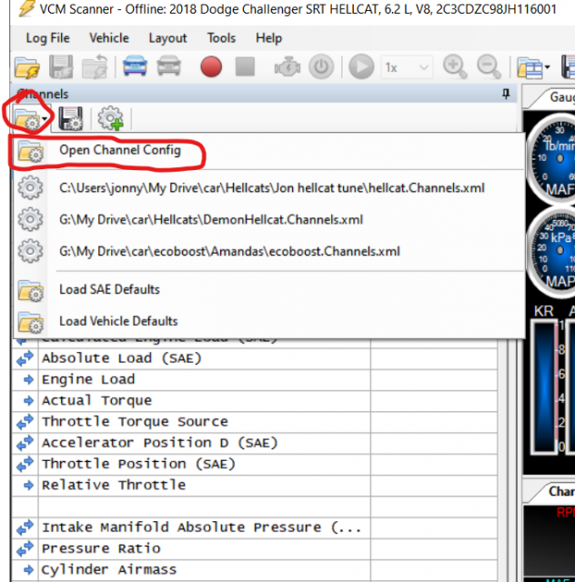

open vcm scanner
Under channels with the folder and gear open the hellcat.channel file

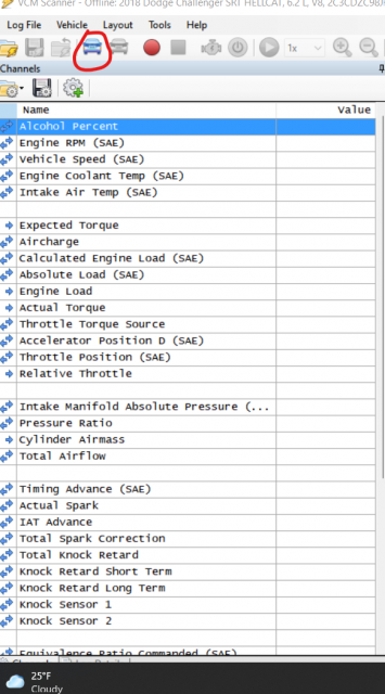

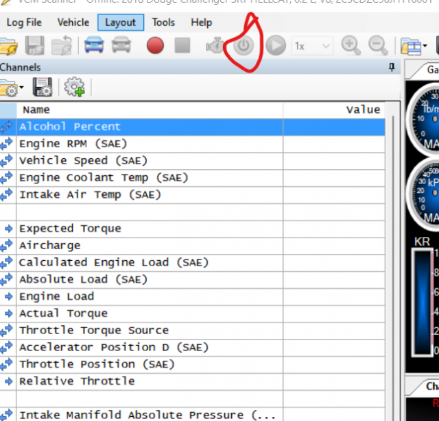

Connect to vehicle by hitting the little car

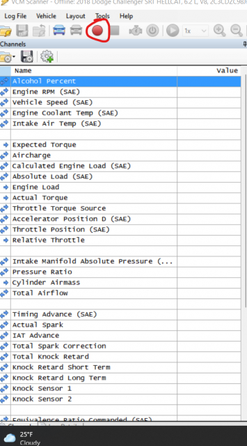

Red button to record and then the blue square to stop record

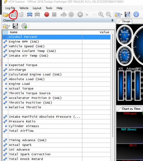

Click the save button to save then email to me
You must disconnect from vehicle before trying to write another tune after a datalog which is the other car button by the connect button. If you dont editor will just say cannot be found.

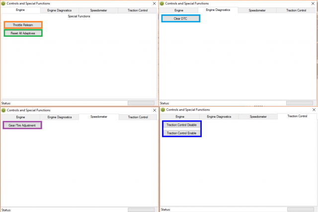

To Reset adaptives
The green square is reset adaptives. It is the only one you have to worry about to reset adaptives.
