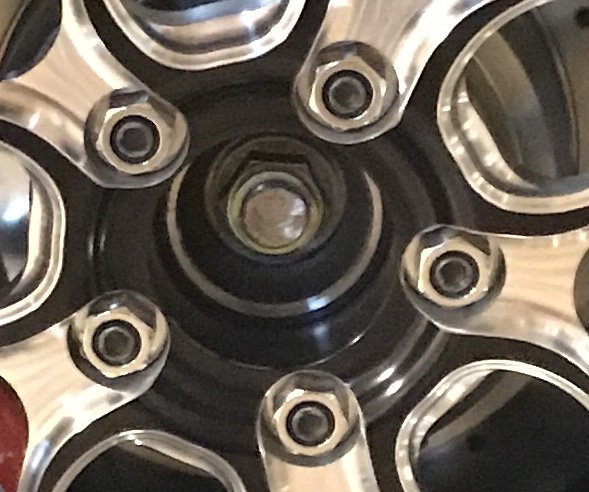

I have Stance Wheels with a certain type of locking lug nut. The stock length fits just fine. At the track I would not mind if I had just slightly longer studs to secure the rear wheels a bit better. Is there such a part number out there or are they just a lot longer as the only other option?

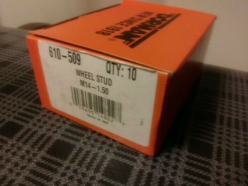

14mmx1.50 RH studs:
https://www.summitracing.com/search...4mm-x-1-50-rh/product-line/dorman-wheel-studs
https://www.hellcat.org/threads/arp-wheel-studs.175001/
You are looking for units with a 16mm or .630" knurl diameter. Underhead length is application dependant.
Not at the moment . They only make one set for us and they are the longer ones .
You could alway cut them off at what ever length you need .

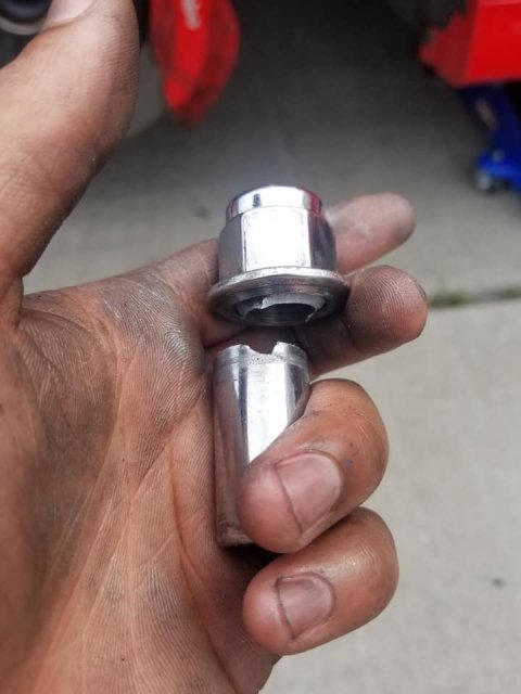

605
1,288
Points

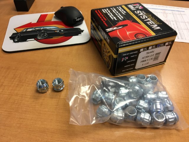

Missed this. I have Dormans. Shop uses them. I like the open lugs that you can see the length of the stud. The NHRA likes that too. 8D301B22-40F5-4450-BFC9-FFE23726356C.jpeg

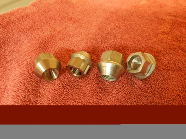

No, that rule does not directly apply to a conical seat lug nut with a bulge. It's the "mag shank" that is the weak point in that type of lug nut. A conical seat lug nut will not "pull apart" like a mag shank lug nut.
. VS

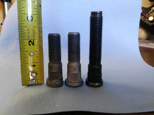

More specifically, the studs would not come completely out of the TI lug nuts on the left in this pic on my car, but if the OEM Demon lug nuts on the right would fit a weld wheel : EVERY thread in that lug nut would be engauged on the stud since they are relieved (look close). 100% safe.

What is the second stud? It looks like about 1/16th of an inch longer.
One is the OEM front and one is the OEM back out of my Demon along with the Dorman stud.. Based on photos I have, I am pretty sure the longer OEM stud is the back.
