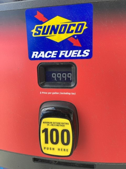

So, now I have Stage 2 installed, every time I want to get full power I need to drain the tank and put in 100 octane. I was thinking it might be nice to just run 100 octane all the time. I don’t use it much so the extra cost is not that horrible ($9.99 vs $4.60/gal). Am I hurting anything (besides my wallet) doing this?
I was thinking maybe using octane booster which would result in about $6-$6.50/gal but then I read reports of plug fouling and suggestions that is is not a good idea to run booster on a continuous basis.
Anyone have experience with either of these?
Though I appreciate all the opinions you guys provide, I would really like to hear from the “been there, done that” guys here.
Thanks!

I'm completely jealous that you have it available at all, regardless of price.
Must be nice to live up there in the clouds, with all of the amusing people.

That is a good price. The guy from vp I talked to said ms109 is good for about a month in the tank. I’m no expert but I suppose you’d be ok as long as you keep filling fresh unleaded race fuel. I’d still run some 93/tune or whatever premium you have periodically, but that’s just me. I have to order my race fuel and it’s $117/5gal:eek:

We have it here in WNY as well....it's been the same price the last 3 years....9.99...in more than a few places

I have run Boostane in my Mustang. No issues just have to change the plugs every once in a while but it doesnt hurt anything. Maybe run some fuel injector cleaner ever so often.
$10 a gallon to DD it? No fukn way bro thats insane! Or is that a weekend cruiser? Either way its 2x the price of E85. E85 requires 30% more fuel volume so ull be getting far less MPG but at half the price of 100 octane so who cares.
Why not get an E85 tune. Will make more TQ to or maybe u dont have access to E85. Only 3 pumps here in CT and they are all 45 minutes from each other.
OR another option is to run methanol with an Alky kit. Edit: I just looked it looks like NH is worse than CT for E85 so forget that idea but shit u can buy them in 55 gallon drums and still cost about as much as 100 octane and ull get way more benifit from it.

I have not changed out my tune for nearly 1.5 years now. The aftermarket suspension controller can be a PIA when we flip tunes so screw it. I add enough of the apparently stale VP109 I have to my tank to make mine ok. Guess in the next couple of weeks I better log a run or two and test his stale gas theory out. The car don’t get used that much but when it does it seems just as fresh and good as the last time. I’ll use up my supply of MS109 in the next month or so. Except for their opinion of it getting bad so they can sell us more, I don’t have a problem running increased octane in my RE continually.
We get the shit end of the stick here in NH on E85. 93 pump gas and 100 octane race fuel or whatever else you can grab in cans is all we have.
I've thought about buying a drum of E85 or something but the management of it, trying to keep water out of it (E85 loves to suck moisture out of the air) is just too much work for me.
Thanks. Yeah, that's what I'm concerned about, which is exactly why I asked. I haven't tried to change plugs in the HC yet, hope I never do, I don't even know where they are! Which worries me... I'm hoping the OEM plugs will go 100kmi, that way they will be SEP (Someone Else's Problem) because I'll be dead! ;) (Or in the home drooling on myself!) :ROFLMAO:
Still would like to hear from those that have run high octane long term and whether it fouls like octane booster. Thanks!

My buddy kept 100 in his 18 Demon full time. No problems.

I don't daily drive mine...(ther're wk. end warriors and an occasional nice weeknight jaunt)....my HC..100/93 50 50 split..even there are those that say ya dont need it with a stock tune.. my 18 demon nothin but 100 from day one..

I do not know why or have heard that high octane fuel formulated as such is harmful.
When I was young we needed all that octane because of the high compressions needed. It was even leaded gas.
Use of other “additives” to increase octane by us non-chemists is a whole other item.:LOL:
