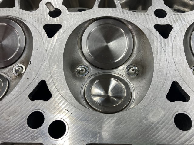

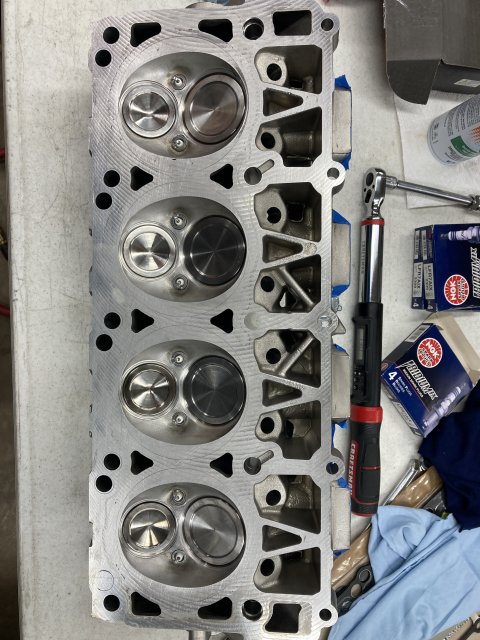

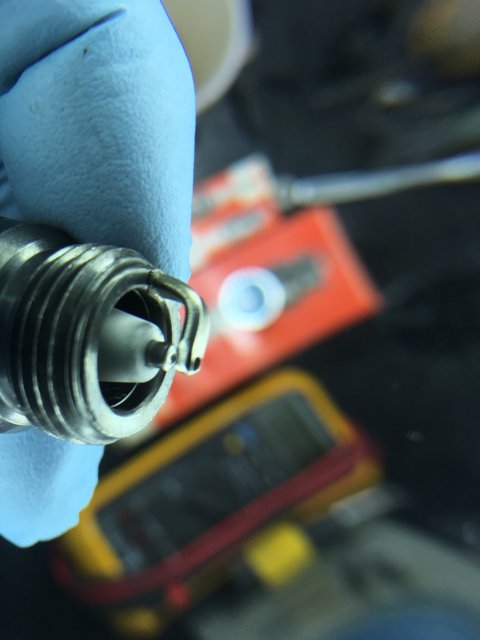

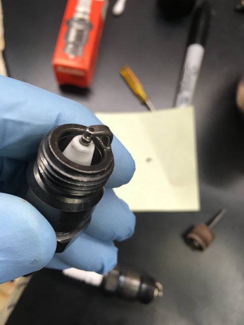

Index? Yes lol, me, always lol Facing towards the intake valve to cool the electrode and keep plug clean from shading of the electrode by the ground strap.
I’ve gone a step beyond and have drilled ground straps even to start the kernel and prevent spark blow out with nitrous lol
View attachment 156676 View attachment 156677 View attachment 156678 View attachment 156679
Hell we used to index plugs back in the 70's still do it on my bikes today
That’s awesome to see. I’m glad people still do it.
This isn’t shocking at all. It’s much more common on bikes nowadays than it is in modern cars. Glad to see that there are still people who can do it and are willing to do it.
