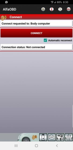

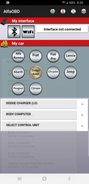

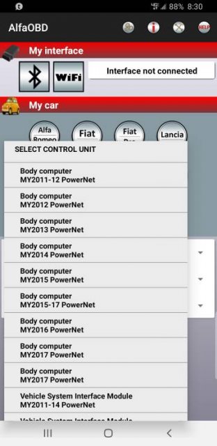

Launch AlfaOBD and choose DODGE/RAM, CHRYSLER, or JEEP. Click the bluetooth button and select your bluetooth OBD client, from the list.
Select your vehicle.
Select BODY COMPUTER.
Tap SELECT CONTROL UNIT and choose your MY Powernet.
Click CONNECT

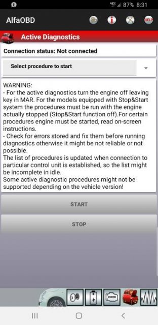

Click SELECT PROCEDURE TO START

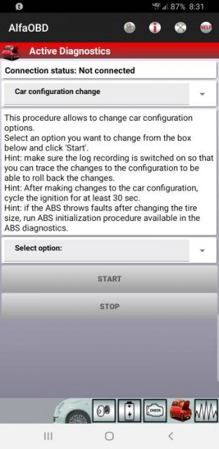

From the drop down, select CAR CONFIGURATION CHANGE
Click SELECT OPTION

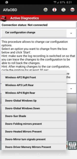

Scroll down to DOORS - GLOBAL WINDOWS DOWN
tapatalk_1567400575761.jpeg Select YES and click START once. In the information box, at the top, the current car configuration will appear. It will tell you if your car is set YES, or NO, or whatever variable you can choose from.
Click CONTINUE and wait. Alfa will tell you something like PROCEDURE COMPLETE and you can close the program and turn off the key, or push the start button to the OFF position.
Remove your OBD client.
Grab your FOBIK and try it out!

NOTE: GLOBAL UP has not been figured out, yet. If you do figure this out, please post it up. Even if selected YES, the windows will not roll back up. If you have a pre 13 LX, what is the FOB routine, to roll the windows back up? Maybe it does work and we just don't know the windows up dance.

In Alfa, select:
Dodge Charger (LD)
Body Computer
Select your Model Year (MY...)

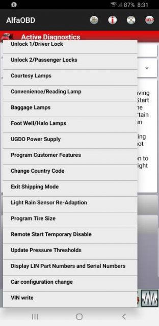

Click: CAR CONFIGURATION CHANGE
Click: SELECT OPTION
Click: CBC FEATURES - DRL DROPOUT ENABLED

I tried the Global windows up on my 2015 with no joy.
Diboblo
Diboblo
#1044
1,324
5,230
Points
Riverside
2015 Dodge Charger Hellcat!
Yeah, I set up and down. Up... no joy.
This is a known issue, but the damned Tazer does it... so it IS possible.
I know Alexie has a lot on his plate. Maybe this will become active, in later updates...
