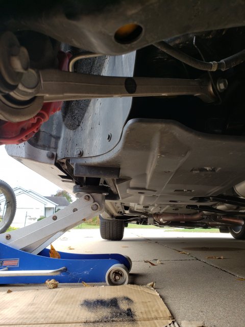

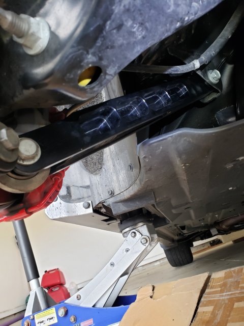

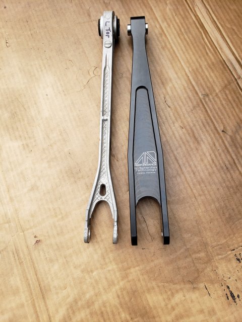

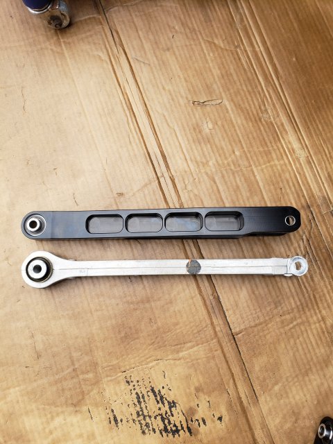

I picked up a set of the AAD trailing/tension arms at the Moparty and installed them yesterday. They make them with either the energy suspension bushings and with teflon impregnated delrin spherical bearing ends. Mine are the delrin spherical ones they call Spheriflex. I was a little concerned about noise but they use these ones in their wheel hop eliminator and drag kit. I put over 50 miles on the car yesterday and didn't hear any noises. On a 4 link suspension going this route can effect hearing gear noise but our rear ends are a lot different with more mounting points. Pretty straight forward with only 4 bolts and all are 18mm. Took less then an hour and they are torqued to 72 ft lb. I give them a 1-2 for difficulty to install. Don't the stock one's look cute:)

I’ve see more than one of those “cute” trailing arms break. One on the dyno. People who don’t change those, don’t know what they don’t know. Good choice.
View attachment 26172 View attachment 26174 View attachment 26175
NICE! I've been looking at those. No other adjustments? alignment? Bolt in and go?
You have any idea what RWHP/torque those failures happened. That's fuc&*^ scary.
3,499
11,261
Most of the modded cars the shop puts out are the common e85 900whp packages. It was one of those that broke on the dyno. That type of failure on track could put you into the wall.
Bolt in and go.
