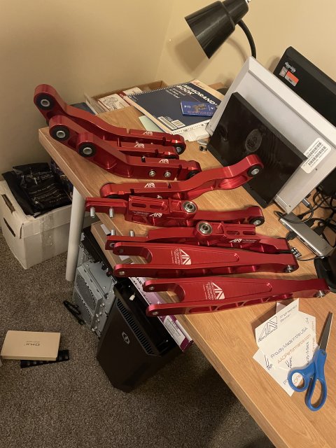

Got the alignment done after installing the AAD Dragpack rear suspension. HUGE difference in drive and handling in a good way. For those that are interested mine needed #4 tabs in the upper tension arm, #6 tabs in the camber arm, and #1 tabs in the toe links. Of course YMMV as each cradle and car can be different. Next up is some track testing and hopefully some low 1.4x 60 foots.
