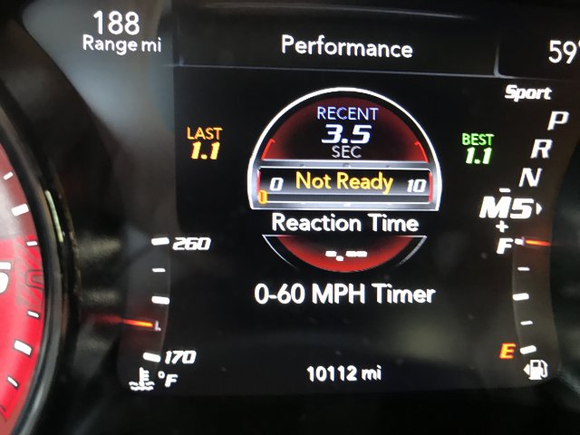

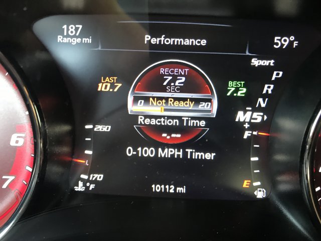

Can you do this on stock perillis on the street? Here’s the facts... 3CEB982F-9FCF-4067-9F17-EEB7F8571977.jpeg 8348C21D-4DFA-45D3-9BBF-7EAE9168DA63.jpeg
20,154
lol, no, not on stock pirellis. has a lot to do with the quality of the local asphalt too
