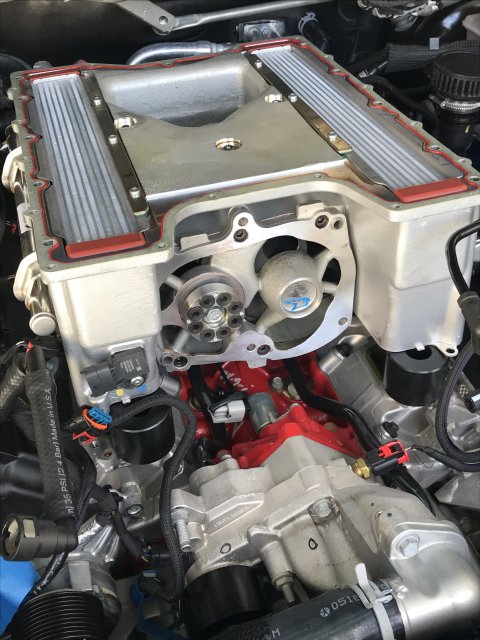

This may be nutty but something struck me when I pulled the snout on my 2.7 IHI setup. When I looked at the end plate holding the bearings for the rotors I thought "Man that thing is crowded!". Meaning, the casting has very little air flow area! I wondered if you added up all the "holes" that let the air through to the rotors what would the surface area add up to? It definitely didn't look like much. Could that be the bottle neck on the IHI? My smaller 2.3 Mag didn't seem that restricted and I've never dissected a Kenny Bell.

Yes, it’s very crowded and I’m sure if someone measured it, it wouldn’t equate to much more than the same area as the stock TB.
Once you get into porting, things can change, but there isn’t a ton of room to be had.
