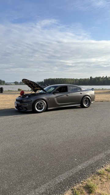

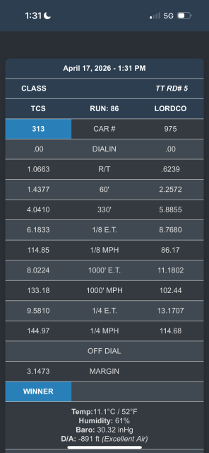

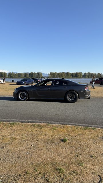

Went 9.58 @144.97 with a 1.43 60ft on a stock blower (not ported) and stock motor setup.

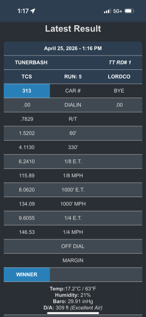

backed up by a 9.60 @146.5 with a lazy 1.52 60ft.
The car has a SHR Type 3 transmission in it with the stock converter.
This was all full weight at 4650 pounds with me in it.
2.46 upper pulley and stock lower pulley on pump E85. tests between 83-89 usually.
This was all on a soft leave as i am fighting traction with a hotter tune.
I think the car has more in it with enough practice and a better 60ft.
