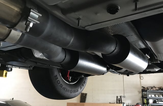

Yes. They just came out with the 3.5” collector in the last year. I purchased the headers and 3.5 X-pipe and not the 3.0” mufflers that come in the complete system. Then I custom fit the 3.5” straight thru Flowmaster Race mufflers. Alex at BBP said that my motor would benefit from the bigger system. B31C17E0-5DDC-498E-8B40-61AD067541A9.jpeg
Key point. You are in the minority of people who might need (not want) a 3.5" exhaust system.
3,630
11,710
I agree. That is probably why the ARH 3.5” system reduces to 3” when it gets back to the mufflers. Either that or they’re too cheap to make 3.5” mufflers. 😂 While I’m the one making decisions on what to go with on my build, much of that is based on asking questions of the right people and going with the answers. When the man building my engine (Alex Jones at BBP) says that in my case the bigger exhaust will work.... I take that advice. A too big exhaust on a motor that doesn’t need it will be counterproductive. My advice to anybody making decisions on what to go with concerning mods is to ask a source like BBP that has experience to know what actually works in harmony with what you’ve got and where you’re going to go.
Necking down pipes is just fine as the exhaust gases cool significantly as they move downstream and less volume is required (and more velocity) as they cool.

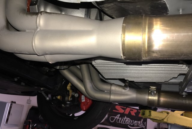

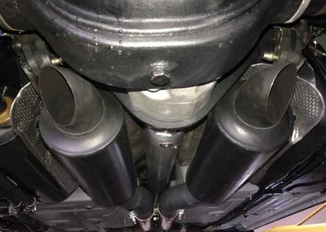

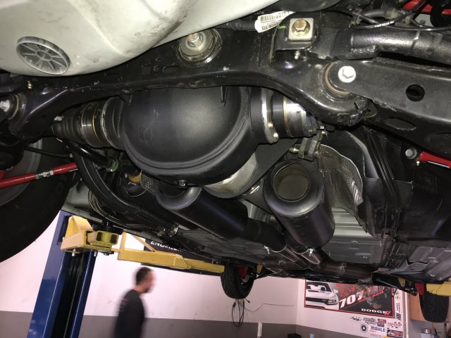

Wow. That was a barrage of info. I just took some pics of mine yesterday. ARH 2x3.5 with 3.5 Flowmaster Race muffs 5CEB5794-97EF-4D7A-A3CF-11F284B9E877.jpeg 04E7CB3E-A5E1-4293-845C-80D652235424.jpeg 06932C46-91E3-4631-90C9-59DF52953BA0.jpeg
